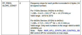

I am trying to understand what the maximum ramp rate for a chirp using the AWR1843AOP.  The data sheet under clock section indicates a maximum ramp rate of 100MHz/usec, but in the mmWave Interface Control Document, it indicates that the PF_FREQ_SLOPE_CONST parameter in the profile settings can be set to a maximum value of 266MHz/usec ( 1LSB=48.279kHz/usec settable from -5510 to 5510)
Is the AWR1843AOP capable of a 266MHz/usec chirp ramp rate?  Are there any limitations to be aware of when using such fast ramp rates?
