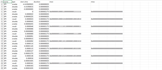

    I took data for 100 frames and dumped them to a csv file, the data is as shown in figure below
    So, when sending max ADC data at 250ms frame periodicity what could be the total number of rows of data which could be obtained in this csv file, each row has 32 bits, in this csv file I get 2457600 rows for 100 frames, could you please verify whether this is correct. What could be the size of the final parsed data array considering each 32bits as two signed int 16 values?
    Yes, this is correct. If you consider it as two signed int16 values, then for 100 frames, you'll have 4915200 entries, where each entry is a signed int16
