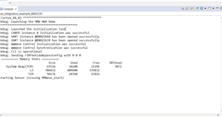

I'm working with IWR6843AOP with CAN Integration Lab (Link :  Integration Lab ) , So after flashing the software into the IWR6843AOP, I observed no activity on the CAN bus. Despite following the recommended switch configurations and verifying the setup, the CAN bus remains inactive.
Then I moved to debugging the software , during debugging, there are no messages transmitted or received on the CAN bus, as confirmed by [CAN USB Adapter and PCAN Viewer] (I'm testing CANFD exemple ).
I followed the switch configuration guide provided in the lab as you can see in the figure below .This configuration was applied to eliminate the errors ,detailed in the second figure .
And finally this the result of the debug console :
But there are no messages transmitted or received on the CAN bus , even in IWR6843AOP or ICBoost Board .
I would greatly appreciate your guidance on resolving this issue : Are there additional steps or configurations required to activate CAN functionality?
