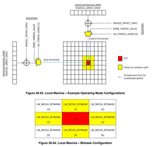

Hi TI expert,
 In the Local Maxima Engine of AWR2944, if we want to change the LM_NEIGHT_BITMASK frame by frame, is there an effective way to do it (see below picture)? Or could TI provide suggestion for how to program these parameters?
