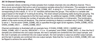

For the channel combining feature described at TRM 28.7.8 is not clear.
How can I set the registers if I need to combine data from four channels?
Please share some executable example.
Appreciated!!

    Currently we do not have any example for Channel combining. I can share few code snippets that can be used as a reference.
    The following piece of code sets the bits CHANCOMB_EN of the PREPROC register in the paramset.
    hwaParamCfg[paramsetIdx].accelModeArgs.fftMode.preProcCfg.chanCombEn = HWA_FEATURE_BIT_ENABLE;
    Also set the HWA common config mask to specify which fields are valid when HWA_ConfigCommon API is called.
    HWA_COMMONCONFIG_MASK_CHANCOMB_VEC_SIZE mask should be used to set channel combining vector and the channel combining size when HWA_ConfigCommon API is called.
    /* Config Common Registers */
    obj->azimFFTCfg.hwaCommonConfig.configMask = HWA_COMMONCONFIG_MASK_STATEMACHINE_CFG |/* numLoops, paramStartIdx, paramStopIdx combined here */
                                            HWA_COMMONCONFIG_MASK_TWIDDITHERENABLE|
                                            HWA_COMMONCONFIG_MASK_DCSUB_SWVAL |
                                            HWA_COMMONCONFIG_MASK_CHANCOMB_VEC_SIZE|
                                            HWA_COMMONCONFIG_MASK_COMPLEXMULT_SCALEARRAY;
    /* Configure the channel combining size register */
    obj->azimFFTCfg.hwaCommonConfig.chanCombConfig.size = cfg->staticCfg.numSteerVecs - 1;
    /* Configure channel combining vector */
    for(i = 0; i < 8; i++)
        obj->azimFFTCfg.hwaCommonConfig.chanCombConfig.vector[i] = 0x33333333; // Sequence of 1100
        // The LSB of the bit-vector corresponds to the first input samples
    /* Now configure the HWA common config registers by calling HWA_configCommon API */
    retVal = HWA_configCommon(obj->hwaHandle, &obj->azimFFTCfg.hwaCommonConfig);
    The above configuration combines two consecutive samples from the membank. If you have the data present in the membank in the required format, then you can add the 4 consecutive samples by configuring channel combining vector accurately. It should follow '11110000' sequence.
    For example, chanCombConfig.vector[0] = 0xF0F0F0F0.
