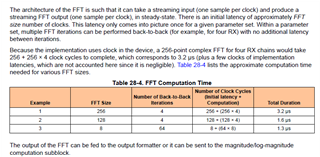

I would like to check if I want to enable the advanced 2DFFT to calculate 64 by 16 input for 500 times, which the following calculation for the execution cycle is correct:
1. 501(B+1)*[64(initial cycle)+64(FFT execution cycle)]*[16(initial cycle)+16(FFT execution cycle)]
2. 501(B+1)*64(FFT execution cycle)*16(FFT execution cycle)
3. 501(B+1)*[64(initial cycle)+64*16(FFT execution cycle*back-to-back iteration)]*[16(initial cycle)+16*64(FFT execution cycle*back-to-back iteration)]
    It should be the second option as per the TRM.
    In the first option, initial cycle which is meant to be added once for all the iterations, is added for all iterations(it's multiplied by 501). And the meaning of the last option is not clear. I am not sure about what you meant by initial cycle, back-to-back iteration.
