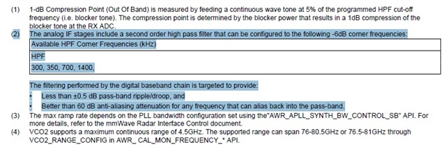

Hi TI Expert,
For HPF (high pass filter) setting in AWR2944, can TI share the frequency response data of HPF for reference? We want to understand the gain suppression vs IF frequency for optimization setting.

Hi Jesse,
Please refer to the following thread regarding the HPF rough estimation could be plotted AWR1642BOOST: Range Resolution vs Spectral Resolution and SNR for Estimation of Range from Concrete Wall - Sensors forum - Sensors - TI E2E support forums
If you need the Matlab, I'll need to check with the team and get back to you.
