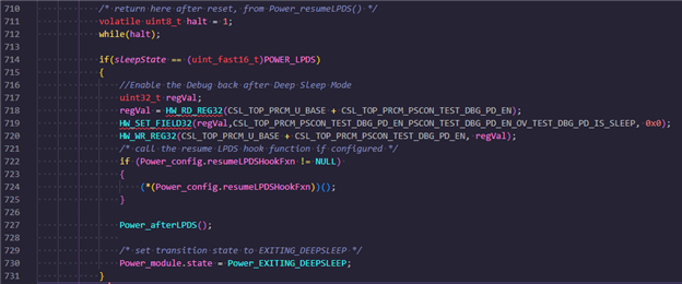

  • Hey Soo,
    I would recommend you do the following so I can debug this further:
    1. Load your program in CCS
    2. Within the Power_sleep function under <MMWAVE_LSDK6_INSTALL_DIR>/sources/drivers/power/v0/power_xwrLx4xx.c, set a breakpoint on line 687 and run your program
    3. Upon hitting the breakpoint which should occur whenever the device attempts to enter LPDS, check the following addresses using the Memory Viewer in CCS:

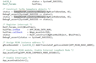

  • Hey all,
    Forgive me for the delay, but I've had the chance to debug this further and was able to resolve the issue I was running into before. The prefetch error was caused by some DebugP_log calls I had for CAN debugging purposes that were affecting application timing.
    For any peripheral, there are three general guidelines for how to properly handle entry and exit of low power mode and ensure proper peripheral operation:
    • Peripheral semaphores must be deconstructed (SemaphoreP_destruct) before entry into LPDS and then reconstructed (SemaphoreP_constructBinary) upon LPDS exit
    • Peripheral tasks must be deleted (vTaskDelete) before entry into LPDS and then recreated (xTaskCreateStatic) upon LPDS exit
    • Peripheral interrupts for the ISR must be reconstructed (HwiP_construct) upon LPDS exit
      • Peripheral interrupts may be deconstructed (HwiP_destruct) before entry into LPDS
    Note: The entry actions can be added into the power_LPDSentryhook - or whatever equivalent user defined entry hook - and the exit actions can be added into the power_LPDSresumehook - also see attached power_management.c.
    As stated before, I based my work off the AWRL6844 CAN Integration project - which is just the mmWave Demo with CAN and hard coded configs - in the Radar Toolbox and made some modifications. I have included the new files and modified files below.
    Since I did not utilize a CAN task in this project, I only deconstructed (App_mcanDeinit) and reconstructed (App_mcanInit) semaphores and interrupts. I will note that I also bumped up the frame period quite considerably to 5000 ms to minimize the chance of frame timing causing issues and currently only transmit one CAN-FD message per frame. Further testing and modification may be needed to determine what is the minimum frame time for a designated amount of CAN transmissions needed.
    Please let me know if you have any issues integrating any of the changes mentioned here and if this resolves your issue.
    Cheers,
    Kristien
