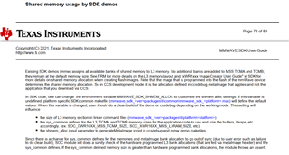

  • if I am modifying MMWAVE_SDK_SHMEM_ALLOC, am i supposed to rebuild the sbl code with the above change and flash it , or does the final application code takes care of it ?
    Please refer to the section Shared memory usage by SDK demos in the user guide. If done correctly the items mentioned in the user guide should be effected
  • I have a similar problem with IWR6843. As I have run out of memory for DSS, I  try to move the DSS program (.text) to L3 memory, without success. The IWR6843 seems only support 0x000006 for the MMWAVE_SDK_SHMEM_ALLOC variable.  I will probably make a related question soon.
    But what I have learned regarding your finding that it works with CCS but not when running from flash, might be due to the fact that the memory is configured by the bootloader when loading meta image from flash. So the CCS debug flash image you run determines the memory partition and your modification of MMWAVE_SDK_SHMEM_ALLOC has no effect when loading the program to RAM using CCS. You would need to recompile the CCS debug image using the modified MMWAVE_SDK_SHMEM_ALLOC to take it into effect. I might be wrong though as I can not get it to work either. The documentation is not clear about this topic and does not explain the MMWAVE_SDK_SHMEM_ALLOC variable at all.
