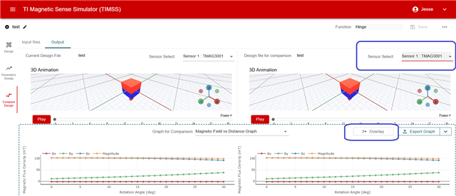

    One option for viewing the simulation results of the two sensors at the same time on one graph is to use the "Compare Design" feature in TIMSS.

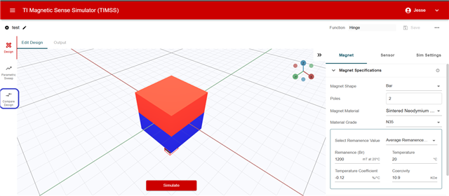

    • Click "Compare Design" in the bar on the left in the simulation environment.
    • Click "Browse My Designs" and select the same simulation to compare them and click "Simulate"
    • In the Outputs tab, make sure "Sensor 1" is selected on one graph and "Sensor 2" is selected on the other graph.
    • Click "Overlay" above the graphs to display the results at the same time on the same graph.

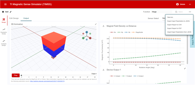

    Alternatively, from the normal simulation results tab, you can click the three dots in the top right corner next to "Save" and Export the report to CSV. This will allow you to analyze the data in excel or other data processing tools and create the graphs you need.
