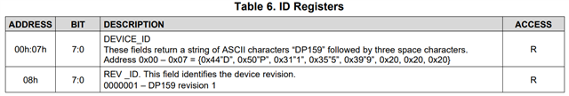

My customer is looking for reading back Device ID/ Vendor ID, do we have such infomation to share and readback?
Please see below example capture from other IC datasheet.

TMP75 does not have the Device ID register. If you require this feature, you must buy TMP1075 instead.
