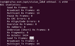

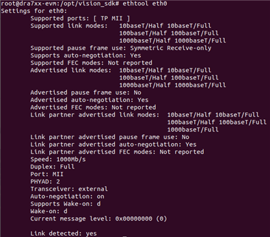

I am using MMWCAS-DSP-EVM, but I am unable to communicate with the host.
Below is the network configuration from /etc/network/interfaces on the MMWCAS-DSP-EVM Linux.
# /etc/network/interfaces -- configuration file for ifup(8), ifdown(8)
# The loopback interface
auto lo
iface lo inet loopback
# Wireless interfaces
iface wlan0 inet dhcp
wireless_mode managed
wireless_essid any
wpa-driver wext
wpa-conf /etc/wpa_supplicant.conf
iface tiwlan0 inet dhcp
wireless_essid any
iface atml0 inet dhcp
# Wired or wireless interfaces
auto eth0
iface eth0 inet static
address 192.168.33.180
netmask 255.255.255.0
gateway 192.168.33.1
#iface eth0 inet dhcp
# pre-up /bin/grep -v -e "ip=[0-9]\+\.[0-9]\+\.[0-9]\+\.[0-9]\+" /proc/cmdline > /dev/null
# udhcpc_opts -R -b
iface eth1 inet dhcp
iface eth2 inet dhcp
iface eth3 inet dhcp
iface eth4 inet dhcp
# Ethernet/RNDIS gadget (g_ether)
# ... or on host side, usbnet and random hwaddr
iface usb0 inet dhcp
# Bluetooth networking
iface bnep0 inet dhcp
Below is the system boot log

when I manually execute systemctl start networking.service, the following is the message output for cpsw eth0
  • I cross-compiled the ethtool tool to the MMWCAS-DSP-EVM and performed tests according to the Basic Ethernet Interface Debug With Linux guide.
    1.link detection
    2.Ethernet MAC hardware statistics
    MMWCAS-DSP-EVM  side
    host side
    The rx_packets on the host side do not increase, and there are rx_crc_errors.Could anyone provide me with some suggestions?
  • RX CRC error counter indicates that packets are received with CRC checksum errors,  but I don't know how to resolve this issue.
    Refer to this post:e2e.ti.com/.../4991780
    I eventually reimplemented it in PROCESSOR_SDK_VISION_03_07_01_00, which I can ping the host in the local network.
