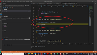

  • Hi Josh, I selected the Quick Eval = enable;
    and also seen the radarCmdString,
    After compiling, the processor hangs at
    void HWI_SECTION HwiP_hardFault_handler()
    But i when do blink LED, with the example code, it blinks the user_LED, and also prints the UART COM16
    I want to know the continuation of program i.e. which function calling which function, what are all their initialization.
    So, I am planning to duplicate the blink LED code, without RTOS. Copy one by one function from the motion and presence detection demo and see what all functions are doing. In CLI initialization it should be HCC. Will my plan work out. or any other approach would you suggest?
    Did you change the MAX_RADAR_CMD as Josh said? This could cause a crash if you do not change it to the right amount of lines.

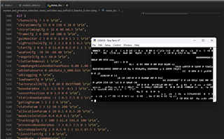

  • Hi Josh, After adding the lines below
    i could see in the terminal,
    here the configuration are hardcoded but, i cant read the output in the terminal.
    I want to get the information like how many humans are detected, co-ordinates(x,y,z) of humans.
    how to display that detected information in the UART terminal??
    I use DebugP_logInfo ("No. of humans detected==\n");
    could you help me on this.

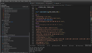

    I'm not sure if the hardcoded configuration is executing as expected in your test. You should not need to add CLI_BYPASS. And I can also see that you have modified MAX_RADAR_CMD_AOP, since you are not using an AOP device you should be modifying MAX_RADAR_CMD instead. Here are the full steps I have taken with the latest SDK (5.5.3.0) to implement HCC with a tracking configuration.

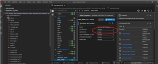

    1. Import the motion and presence detection example project from C:\ti\MMWAVE_L_SDK_05_05_03_00\examples\mmw_demo\motion_and_presence_detection\xwrL64xx-evm to CCS
    2. Set QUICK EVAL to Enable in the MPD_DEMO tab of example.syscfg. Save the file.
    3. Open mmw_cli.c from the project explorer window and replace radarCmdString char array with below. Save the file.

    Then after you connect to the device in a serial terminal with the same baud rate as in the baudrate command of the configuration (1250000 in the configuration above) you should see the stream of UART data.

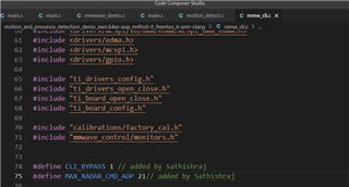

    Our examples output relevant data over UART in the format described here. The raw UART data seen in the terminal will not be readable. The data should be parsed by the host MCU before any additional processing. We do this same parsing of the data when its received by the PC before plotting it in a visualizer/GUI.
    You can use the CLI_write function if you wish to print in the terminal but I don't recommend this as it will probably be too slow. If you want to visualize the data to confirm everything works to your liking before connecting to a host MCU you can use our open source python visualizer (mmWave Industrial Visualizer from the Radar Toolbox).

  • Hi Josh,
    Thanks for the detailed steps. Actually, I am using IWRL6432AOP EVM. So only changed the MAX_RADAR_CMD_AOP configuration.
    Once Built with given Hardcode configuration file, i am getting data in the UART in very speed plotting in non-readable format.

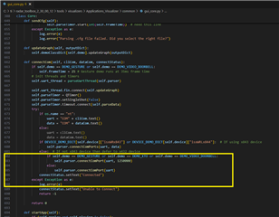

    In the Industrial visualizer source code, it is already set with baud rate (uart1250000)".
    But in Industrial Visualizer, which demo need to select? actually i tried all with by selecting start without send configuration
    But I dont see any plots there. It is simply same as before. But when i open in the UART terminal data is continuously plotting(by this time i closed industrial visualiser and vise versa).

    Okay. I understand that you don't want to see the data in the visualizer. Just to clarify my point. If you refer to my previous post I mentioned "Line 685 of gui_core.py (RTB 2.30.00.12) should be changed to "self.parser.connectComPort(uart1250000)""
    This is not correct. You need to make line 685 the same as line 683 in the picture you sent. Then the start without send configuration will work. And to answer your question for the motion and presence detection demo you should select x432 Out of Box Demo.

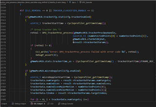

    Josh Said
    1.  the tracked targets and their coordinates are stored in &result->trackerOutParams.,
    In this code, where should (line number) I place the  CLI_write() to get the tracked target and their coordinates, could you give me full syntax/code to print the data in UART. Actually when flashed, this code continuously printing data to the UART(non-readable format).  So first we should stop that default printing for visualizer and then we have to start print our required data. How to do that?

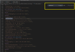

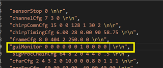

    3.  You will also want to change the guiMonitor configuration command to all 0 to disable the normal data output so that you can read the values you are printing.
    guiMonitor present is four places in the motion_detect.c file, which one need to be changed, (FYI, it is all in disabled state). I changed all all four to zero.
    [guiMonitor 0 0 0 0 0 0 0 0 0 0 0],
    after this step also, I am getting data in UART as non-readable only.
    Providing custom modifications to the demo code is outside the scope of these forums.
    This would indicate that the guiMonitor command in the configuration still enables some outputs.
    radarCmdStringAOP is the character array that you need to modify. It is located in mmw_cli.c not motion_detect.c.

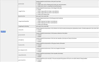

    Question 1: Regarding discarding a digit in guiMonitor
    I played with guimonitor, giving 1 at various position.
    I am getting data from
    mmwDemo_TransmitProcessedOutputTask() at motion_detect.c
    But I have doubt, in the sdk document guiMonitor has 12 digits/position
    But in all chirp_configs files given in examples has 11 digits only. How? Which one digit need to discard?

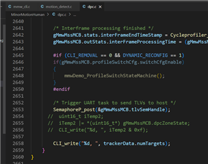

    Question 2: Variable name converted as integers to print UART
    In the dpc.c file at the end the  DPC_Execute(), function i would add the CLI_write("%d, ", required data);
    I want required data to be filled as integer. But In the demo code the variables are declared as global structures, structures, pointers. So I don't know how to get the data from result->trackerOutParams and result->microDopplerOutParams as integers to print in  CLI_write().
    The 12th position is optional and was added in a later update so many default configurations do not have it. I'm not sure what you mean by "which one digit". If you want to disable the normal UART demo output then all positions for guiMonitor should be 0.
    At the end of dpc_execute you could iterate through each of the tracked targets with something like a for loop. There is a numTargets variable in result->trackerOutParams that could be used for this. You will need to dereference the pointers/cast the data to the appropriate type.

    "maxAcceleration 0.4 0.4 0.1 \n\r",
    "trackingCfg 1 2 100 5 61.3 191.7 100 \n\r",
    "presenceBoundaryBox -2 2 -2 2 0 2  \n\r",
    "microDopplerCfg 1 0 0.5 0 1 1 12.5 87.5 1 \n\r",
    "classifierCfg 1 3 4 \n\r",
    I get the error throwed, code is not executing. In the tuning guide it is mentioned that we cant use both trackingCfg and minorStateCfg at the same time.
