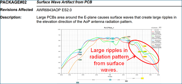

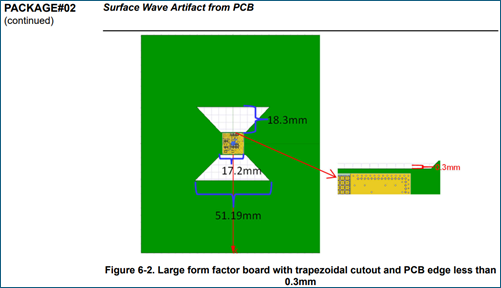

      When they checked the 'AWR6843AOP Device Silicon Errata' document you answered, the following is indicated.
      AOP Package is currently placed at 45x30mm PCB Center because it was not possible to check that document during the initial design.
      Q1) Is it necessary to cut the PCB around AOP Package like the document?
      Q2) Or do I just need to not place the top layer copper/parts of the PCB?
      Q3) If they don't cut the PCB and you don't see the large ripple on Simulation, is it okay not to follow the guide?

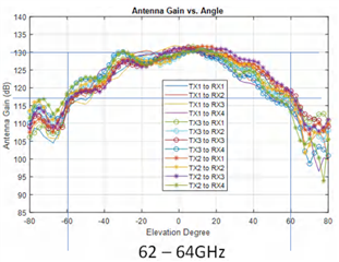

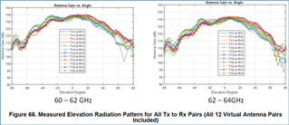

  • 2. FOV Judgment Criteria
    *WR6843AOP FOV performance is 120 degrees X 120 degrees.
    However, if you look at the FOV measurement DATA of DATA SHEET, it seems that Elevation does not come out at 120 degrees.
    Q1) Could let me know how many dB TI uses for FOV judgment?
    Q2) According to the measurement results below, it seems to be less than 120 degrees even based on 12 dBfs. What are the criteria for TI to say FoV 120x120?
    Q3) Is the result of the measurement when Radome is not present?
  • Hi Lina,
    1) Yes it is strongly recommended to follow the guidelines.
    2)Not placing component near to the elevation direction will not help in this case.
    3) We leave that to customer. We have no problem if they are okay to manage ripple levels on their simulation results.
    I have few more comments on my previous reply. As I mentioned at least 30 degree clearance is needed from FoV perspective. Moreover, it is recommended to place the electromagnetically conductive materials > lambda(wavelength) distance away from IC package edge to eliminate surface wave effects. You can see in the checklist some of the decaps should be placed very close to the BGA ball. In that case decaps can be placed at the bottom near to the BGA ball.

  • Hi Lina,
        On an average it is approximately taken 12dBfs to determine FoV. There may be some relaxation slightly.
    Thanks and Regards,
    Sivaprasad
  • Hello Sivaprasad,
    Thanks for your support. I have an additional question.
    Cutting the PCB physically is not easy.
    Instead of physically cutting out the PCB, would it be okay to remove the copper from all layers in the specific area?
    Thanks.
    Beomseok.
  • Hi Beomseok,
    It is necessary to remove complete material on elevation side of the IC as recommended. Just by removing copper from all layers will not help in this case. It is not catastrophic if you didn't make a cutout in the PCB. But according to your end use case please ensure you have enough margin to tolerate these ripples.
