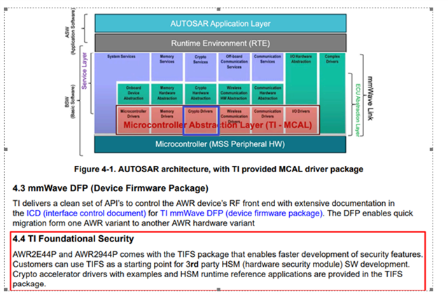

Hi AWR2944P Team.
A customer wants to use the AWR2944P part to implement a security feature in an automotive application. It is requested by a partner company related to HKMC in Korea,
I need MCAL driver release to support TI Foundational Security Resource and AutoSAR OS, please let me know if it includes Crypto Driver.
Please provide the request link or procedure to provide the above 2 packages.
https://www.ti.com/lit/wp/spradp2/spradp2.pdf?ts=1736908904020&ref_url=https%253A%252F%252Fwww.ti.com%252Fproduct%252Fko-kr%252FAWR2944P
In addition to AWR2944, please let me know if you can provide information on AWR2E44P as well, as I seem to have received AWR2E44 information from an end customer that is not publicly available on ti.com.
Thanks.
Jack
  • Hi Jack,
    TIFS is not compatible with Autosar. Customers have to work with 3rd party HSM stack vendors to get a Autosar compatible HSM stack.
    Please reach out to local FAE to know about 3rd parties which are offering HSM solution on TI Radars.
    Ajay
