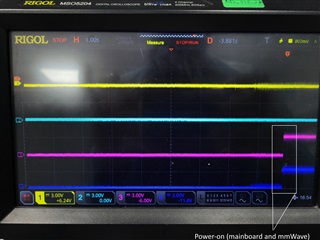

    Below are the captures of SOP0,1,2 and nReset.
    SOP2 is in Yellow, Probed at R203 towards the sensor
    SOP1 is in Light Blue, probed at R206 towards the sensor
    SOP0 is in Pink, probed at R209 towards the sensor
    nRESET is in Dark blue, probed at the output of the AND gate and towards the sensor
    Case 1: Both boards powered at the same time
    In this case, 5V is supplied to the mainboard using a DC adapter, and the same also powers the mmWave board through the B2B connector. UART does not show in this case and board (seemingly) boots into flashing mode. Configuration of S1 in this case (from 1 to 6): 001100

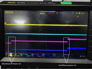

    Case 2: Mainboard powered first then mmWave board is powered
    In this case, 5V is supplied first to the mainboard through the DC jack, and after a delay the mmWave board is powered. The board does boot into functional mode and we are seeing the UART logs. However, one important observation here is that the nRESET and SOP pins pulled up to 3V3 do not rise from proper 0V and instead, it seems to rise up from some kind of floating state that is offset positively from 0. This is not observed when we isolate the UART pins, in which case nRESET rises from proper 0 and board goes into flashing mode. Configuration of S1 in this case (from 1 to 6): 001100

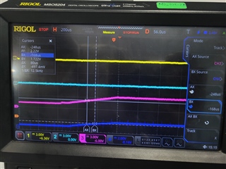

  • Hi Ankit,
    I have re-captured the waveforms by adjusting the time scale. For the nRESET, I have placed the cursors at around 1.5V and for the SOP signals, as per the datasheet the Vih mentioned was 2.25V so I've approximately placed the cursors there.
    Case 1:
    SOP0 seems to rise 160us before nRESET

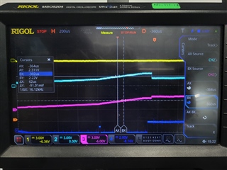

    Case 2:
    in this case, its similar although the signals seem to be rising from a non-zero state (initial power-on of the carrier board was done earlier and hence the rise from 0 was not captured in this frame).

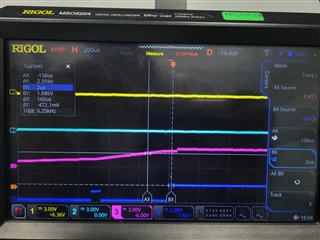

    Case 3:
    I have captured the delay betwen SOP0 and SOP1 rising, since we already have the SOP0 vs. nRESET delay.

  • Hi Bharath,
    The VIH for NRESET and SOP signals is 1.57V, please see below.
    It looks like a NRESET release is happening for shorter period (above VIH) before proper release in the below shown image booting up the device in undefined SOP MODE: 000. Can you check this on another EVM apart from 2?
