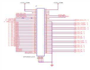

Hi, All.
For data logging using DCA1000, what's the signal should be routed?
RDIF (x12), SPI (x4), UART (x2), RESET (x1) are enough?
<AWRL6432 EVK>                                                            <DCA1000>
I already check the below question (for AWR6843)
https://e2e.ti.com/support/sensors-group/sensors/f/sensors-forum/1363675/awr6843-interface-with-the-dca1000?keyMatch=dca1000%206843&tisearch=universal_search
