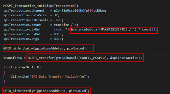

I'm tring to read radar cube data via spi. I'm using the example soruce code from radar toolbox.
Basically I could read radar cube data with setting.
/* 1 -> Raw ADC, 2 -> 1D FFT, 3 -> 2D FFT, 0 -> No Transfer*/
#define SPI_DATA_STREAMING 2
/* 1 -> Via FTDI Chip, 2 -> Via Logic Analyzer, 0 -> No Transfer */
#define SPI_DATA_STREAMING_MODE 1
What i want to change here is I want to send the data with callback mode not blocking mode, so that the radar can do doa and cfar dpu during transfering the spi data.
For this i changed code like below, but it didn't work.
Where shoud i change the code or what should i add?
Is that possible to send spi data by callback mode and peripheral mode?
MCSPI_OpenParams gMcspiOpenParams[CONFIG_MCSPI_NUM_INSTANCES] = {
        //.transferMode        = MCSPI_TRANSFER_MODE_BLOCKING,
        .transferMode        = MCSPI_TRANSFER_MODE_CALLBACK,
        .transferTimeout     = SystemP_WAIT_FOREVER,
        //.transferCallbackFxn = NULL,
        .transferCallbackFxn = App_callbackFxn,
        .loopback            = MCSPI_LOOPBACK_DISABLE,
        .msMode              = MCSPI_MS_MODE_PERIPHERAL,
        .mcspiDmaIndex       = 0,

  • Dear Sharan
    spi callback function is triggered by MSCSPI driver after finishing trasnferring data  from what i understood.
    I want to send major and minor radar cube data through spi
    If I send the data by blocking mode which is implemented at radar tools soruce  code the timming chart is like below.
    What i want to change is that i want to send data by spi dma and callback mode, so that i can send the major data while doppler and cfar processing.
    This is radar tool's example code for sending radar cube data via spi.
    Sequenc is like this:
    spi busy low(inform to master for starting spi communication) --> spi transfer (when master starts communication, sensor will send the data)
    --> spi busy high
    I want to change the sequce like below:
    --> spi busy high --> spi transfer (when master starts communication, sensor will send the data) --> callback is triggered after tx --> spi busy high at callback function
