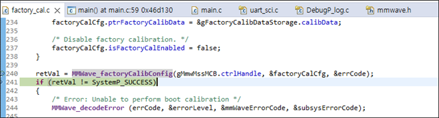

Hi team,
This is Lina covering radar in Korea.
My customer has a problem about "Error: Factory Calibration Failure"

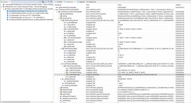

When they downloading the same code to samples made with AWRL6432 ES2.0, after then Error occurred in the process of checking the progress (2 out of 30 samples).
Please check the cause of the error and if there is anything they need to pay attention to in the code to prevent the error.
Error code: -205848574
errorLevel: 2
mmWaveErrorCode: -3141
subsysErrorCode: 0
