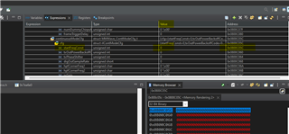

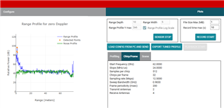

I am currently using the demo for the AWR6843 (SDK 3.6, debug mode) to visualize the range profile. As shown in the attached screenshots, changes in the frequency parameter within the corresponding .conf file are reflected in the mmWave Demo Visualizer. However, I’ve noticed that the StartFreqConst value in the Expressions view always displays zero, which seems unexpected. Interestingly, this value changes to 134241480 when an error occurs during the loading process.

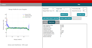

Additionally, I observed that the device can run with a frequency set to 58 GHz, even though the device guide specifies an operational range of 60 GHz to 64 GHz.

  • Sorry for forgetting to attach the screenshots in my previous message.
    Thank you for reaching out regarding your question on the start frequency. It appears you may be looking at the wrong structure, continuousModeCfg. This is only utilized when the data output mode is set to continuous which likely explains why its value never changes from zero until an error occurs. Instead, you should be able to reference the ptrMMWaveMCB->ptrProfileList which is a list of profileCfgs which should contain a startFreqConst field.

    Through the use of VCO1, the AWR6843ISK can operate within 57-60.5 GHz, but we do not officially support this frequency range.

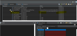

    Regarding the line you suggested (), I have checked all variables on gMmwMssMCB, as shown in the newly attached screenshot. The available data appears to match what is shown in the Expressions window.
    As I mentioned in my initial message in this thread, I observed that all range profiles at different frequencies remain unchanged (please refer to the attached images in my first message). Given this, I would like to validate whether the firmware is running with the input frequency specified in the configuration file.

  • Hey Ramin,
    I apologize for any confusion here on my part, but the screenshot you are showing appears to be displaying the startFreqConst from the continuousModeCfg which as stated before, does not contain the actual starting frequency unless data output mode is set to continuous. You need to look at the ptrProfileList that is accessible anytime gMmwMssMCB is recasted to MMWave_MCB for MMWave functions.
    It is expected that the range profiles at different starting frequencies wouldn't change that much. Given the same environment, the range profile could only really change if the antenna layout was adjusted which would influence the strength of the SNR response. If the sweep bandwidth decreased, there would be a drop in the resolution of the range profile, but the overall shape would likely stay the same, unless there was a significant drop in bandwidth.
