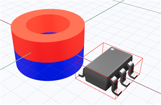

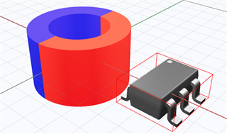

    The magnet in the kit is axially magnetized, and not very ideal for rotation applications. See below to see the difference between Diametric and Axial polarizations.
    Diametric magnet
    Axial magnet
    If the axial magnet were to spin about the Z-axis (your motor shaft), then the sensor gets exposed to an unchanging magnetic field vector due to the relative symmetry.  However in the case of the diametric magnet, the radial and tangential components of the field vector will oscillate.  The resulting sine and cosine of the X and Y field components should allow an angle calculation using arctangents.
