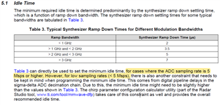

I know that there's a minimum of a couple of micro seconds, based on the bandwidth used, in my case is 3.5us.
And it should also be a bit higher if I use a low sampling rate, which I do (4 Msps).

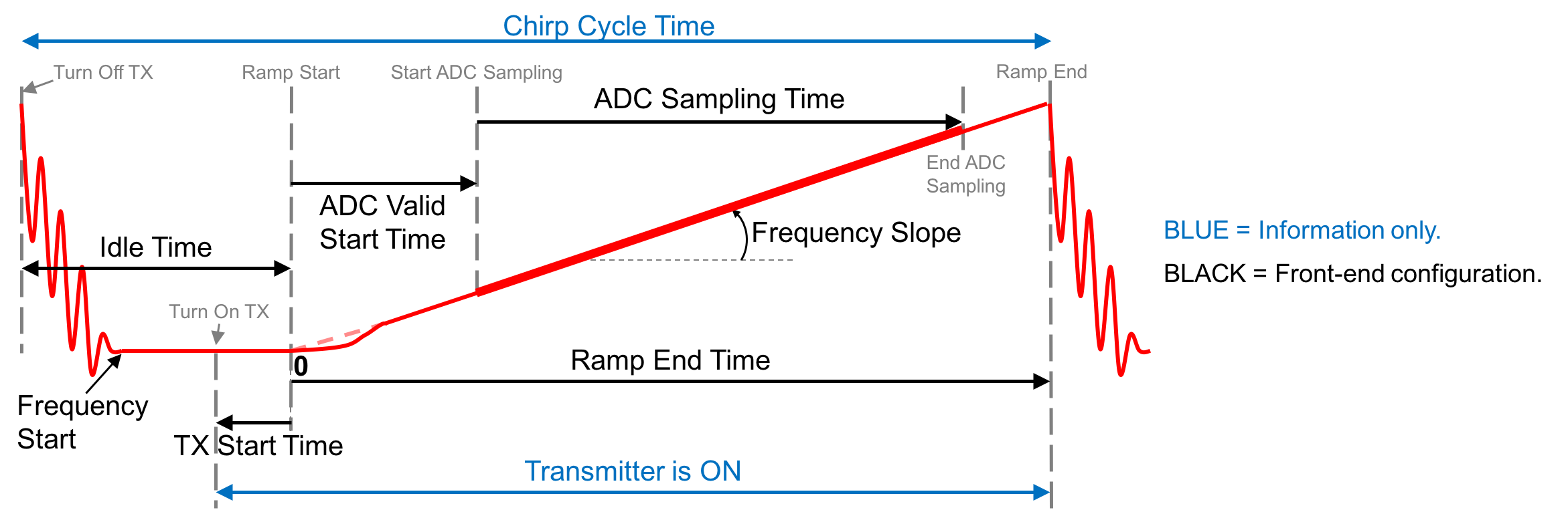

I also know that as I lower the idleTime, it increases max velocity and velocity resolution, while it lowers
compliance chirp time and RF duty cycle.

  2. Does it impact motion sensitivity? A higher velocity resolution would mean a loss in motion sensitivity, right?
  3. What is the compliance chirp time?
  4. Is it essentially just a tradeoff between a higher velocity resolution and power consumption (RF duty cycle)?

  • Hello Ed,
    You have the main effects of idleTime correct, but anything more is a bit of an open discussion because saying "system performance" is a bit vague. You could say something along the lines of a larger idle time increases performance because it allows additional buffer time needed to run more complex processing algorithms.
    The larger the velocity resolution value, the more variance you will see in velocity measurements, thus it being less accurate.
