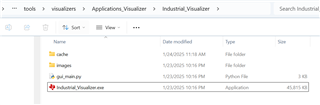

    3. Now opened virtualizer from following path:
    C:\ti\radar_toolbox_2_30_00_12\tools\visualizers\Applications_Visualizer\Industrial_Visualizer\Industrial_Visualizer.exe
    4. In Virtualizer click on connect. Device connected as shown in below image:

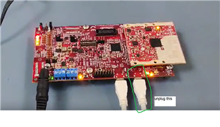

    Image of sensor for reference:
    Image of MMWAVEICBOOST for reference:
    Please let me know if I am missing any step?

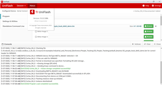

    Something is going wrong in the flashing process. The device is not recognizing the commands for the people counting demo. Can you show screenshots of successfully flashing the board?
    Nate
  • Please find snapshot of successfully flashing:
    Also find the log of flashing as below:
    1/27/2025, 11:56:11 AM] [INFO] Cortex_R4_0: Initialization complete.
    [1/27/2025, 11:56:11 AM] [INFO] Cortex_R4_0: Flashing process starting...
    [1/27/2025, 11:56:11 AM] [INFO] Cortex_R4_0: Connecting to COM Port COM3...
    [1/27/2025, 11:56:11 AM] [INFO] Cortex_R4_0: Reset connection to device
    [1/27/2025, 11:56:11 AM] [INFO] Cortex_R4_0: Set break signal
    [1/27/2025, 11:56:11 AM] [INFO] Cortex_R4_0: Connection to COM port succeeded. Flashing can proceed.
    [1/27/2025, 11:56:11 AM] [INFO] Cortex_R4_0: Reading device version info...
    [1/27/2025, 11:56:11 AM] [INFO] Cortex_R4_0: ** 1 files specified for flashing.
    [1/27/2025, 11:56:11 AM] [INFO] Cortex_R4_0: Checking file C:/ti/radar_toolbox_2_30_00_12/source/ti/examples/Industrial_and_Personal_Electronics/People_Tracking/3D_People_Tracking/prebuilt_binaries/3D_people_track_6843_demo.bin for correct header for IWR6843.
    [1/27/2025, 11:56:11 AM] [INFO] Cortex_R4_0: IWR6843 device, fileType=META_IMAGE1 detected -> OK
    [1/27/2025, 11:56:11 AM] [INFO] Cortex_R4_0: !! Files are valid for IWR6843.
    [1/27/2025, 11:56:11 AM] [INFO] Cortex_R4_0: Format on download was specified. Formatting SFLASH storage...
    [1/27/2025, 11:56:11 AM] [INFO] Cortex_R4_0: -->Erasing storage [SFLASH]
    [1/27/2025, 11:56:11 AM] [INFO] Cortex_R4_0: -->Sending Erase command to device...
    [1/27/2025, 11:56:22 AM] [SUCCESS] Cortex_R4_0: -->Erase storage completed successfully!
    [1/27/2025, 11:56:22 AM] [INFO] Cortex_R4_0: Downloading [META_IMAGE1] size [625668]
    [1/27/2025, 11:57:38 AM] [INFO] Cortex_R4_0: SUCCESS!! File type META_IMAGE1 downloaded successfully to SFLASH.
    [1/27/2025, 11:57:38 AM] [INFO] Cortex_R4_0: Disconnecting from device on COM port COM3...
    [1/27/2025, 11:57:38 AM] [INFO] Cortex_R4_0: Flashing instance clean-up initiated...
    [1/27/2025, 11:57:38 AM] [INFO] Cortex_R4_0: Instance deinitialized!
    [1/27/2025, 11:57:38 AM] [SUCCESS] Program Load completed successfully.

    4.  flashed following bin file:
         C:\ti\radar_toolbox_2_30_00_12\source\ti\examples\Industrial_and_Personal_Electronics\People_Tracking\3D_People_Tracking\prebuilt_binaries\3D_people_track_6843_demo.bin

    8. Now opened visualizer from following path:
    9. In visualizer  click on connect. Device connected as shown in below image:

    Can you try with the USB plugged into the FTDI port unplugged? Perhaps this is getting in the way of the UART. This demo doesn't need the FTDI to run.
    Nate
  • Hello Nathan,
    I removed FTDI cable and followed same process. Still demo is not working.
    Arifchand Mulani
    I wonder if there is something wrong with the board hardware. Are you able to test on a different board that plugs into the MMWAVEICBOOST? Such as the IWR6843ISK or IWR6843AOPEVM?
