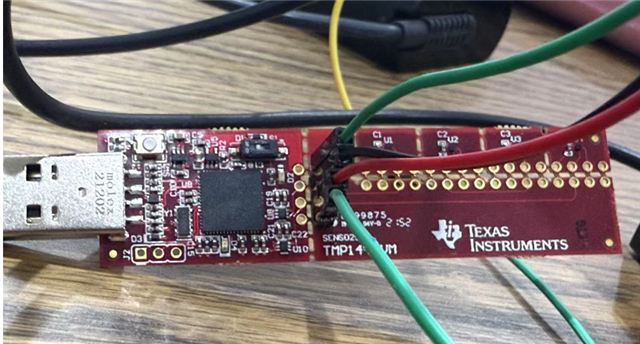

By External port
 I only connect TX RX and GND
Send :
55 8c 90
Receive
00 00
70 00 01 80 01 C0

        I didn't now have new schematic . I Just use  the TMP144 EVK baord directly and only used  and USD to serail port to connect to RX TX and GND.
  • If U9 logic translator is powered on the EVM, it will interfere with your attempts to transmit. It would be best to disconnect the sensors at the perforation.

  • Hi,  Ren
         I just check the baord .And I tried to click S1 off to see any different .  The D2 LED will be light on.
    And now I can not connect the over over GUI now. I am not sure did I do any wrong operation.
    I checked the EVM TX is alway be high(3.3V ).
    As you said the U9 will impact the exteranl port. So does it will working if I cut off the board
    to dicusconnet the U9 and sesor baord. and if I cut off it does the command command wil be different ?
    Kent Yeh

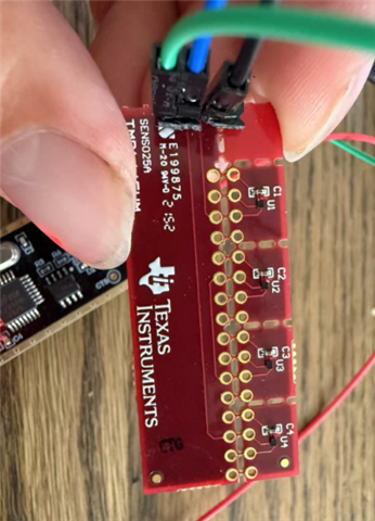

  • S1 is not helpful in your case. To prevent U9 from interfering, I recommend breaking the board at the perforation (red line.) You can reconnect the boards on a proto board if needed.
    The commands sent assume 4 devices. There is no change to the commands unless you separate the individual TMP144 boards.

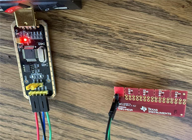

  • Hi, Ren
      I try to cut off the baord but still not able to receive any feedback. I not sure does my EVM baord was damaged ?

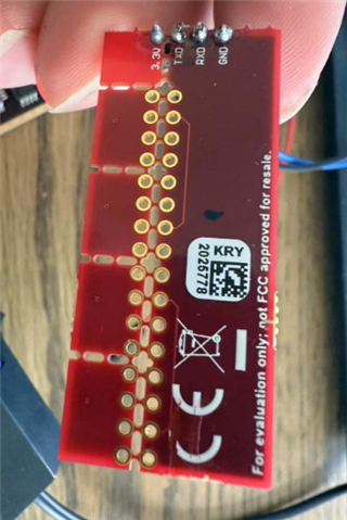

    BTW want to double check did I need to connect 3.3V for the sensor baord?
  • Yes, you will have to provide 3.3V to the sensors.
    I don't have reason to believe your sensors are damaged at this time.
    thanks,
    ren

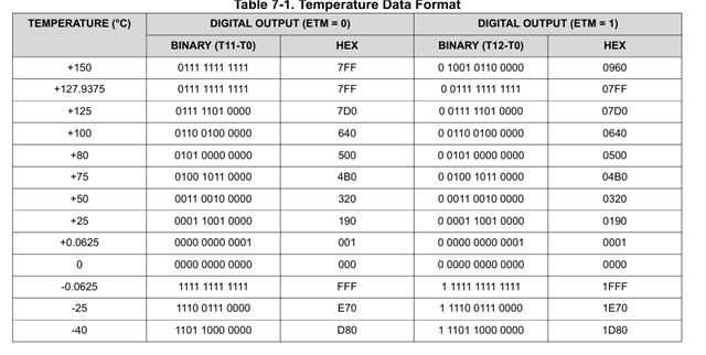

  • Hi, Ren
       I jsut get a new baord and after cut off the baord now I can get the data same with , But I am not sure how to caualute the vaule to reallt tempture.
    S:55 F1   ==> R: 55 F1 80 16 50 16 40 16 40 16
    S:55 F3   ==> R: 55 F3 00 02 00 02 00 02 00 02
    S:55 F5  ==> R: 55 F5 00 F6 00 F6 00 F6 00 F6
    S:55 F7 ==>  R:55 F7 00 3C 00 3C 00 3C 00 3C
     I check the spec  tem data is here but I can not not sure how to reading  for each sensor.
