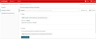

  • Hey Madhusudhan,
    How are you downloading the appimage to the backup meta image address? If you are using UniFlash, please verify under Settings & Utilities -> Format that Format SFLASH Memory during flash file download is disabled and then attempt to reflash the meta image and then SBL.

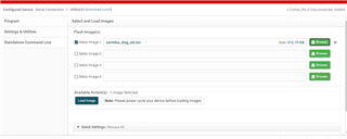

    Could you try re-flashing meta image 1 and the application into meta image 2 using UNIFLASH and reporting whether you are still observing the same issue when you are resetting. Thank you.
    Vignesh K.
  • Hello Vignesh,
    Tried to Flash using the teraterm. Still facing the same issue. Thanks
  • Hi Madhusudhan,
    Do you have the SBL on meta image 1 and your applications in the next images? Could you also please try doing this through UNIFLASH? I understand it may not be accurate to the partitions you want to do but I am curious if it will work through UNIFLASH, because then we can narrow down the problem more.
    Vignesh K.
  • Hello Vignesh,

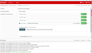

                I tried to Flash SBL on meta Image 1 and application on the meta Image 4. i dont see SBL or Application being booted after that. here i have shared the screenshots below. Thanks

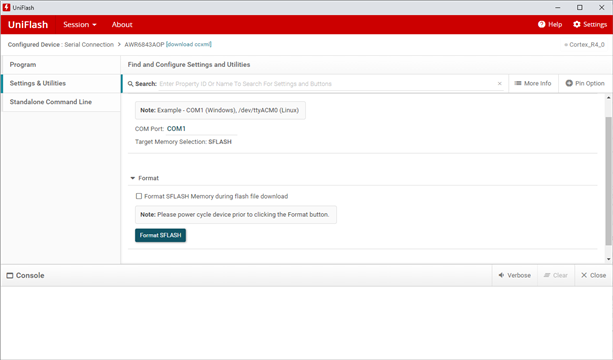

    I apologize for the late reply. This is happening after you power cycle and change the mode to functional, is this correct? If it is saying that the flash was successful and you are not seeing any changes on your device I suggest the following:
    1. Turn off format SFLASH
    2. Try to flash only the SBL image in the first image
    3. Power cycle the device
    4. Try to flash only the application image
    5. Power cycle the device again and see if you recognize any changes.
    Let me know what happens, I really hope this resolves your issue!
    Vignesh K.
  • Hello Vignesh,
           Like you mentioned i have turned off the SFLASH and loaded SBL alone initially on meta Image 1. i did turn off and on the device. Later , i Flashed the application from the metaImage selection 4. Now changed the device from Flash mode to Functional Mode. However no changes were observed. SBL was not booting up. i see blank screen on teraterm as before. Thanks

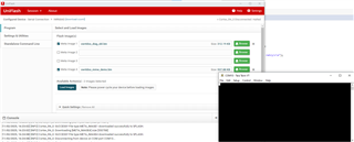

  • Hi Madhusudhan,
    Could you try your example using UNIFLASH again but while trying to flash all your required images at once. So with the SBL image in Meta image 1 and the demo in image 4. Let me know if this fixes any issues.
    Thank you for your patience.
    Vignesh K.
