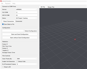

  • I want to demonstrate 3D People Tracking in Industraial Visualizer, but I can't find the Configration data.
    Where is the data?The device used is IWR6843AOP.
    Download the latest version of the Radar Toolbox here using the "Installing the Radar Toolbox" and "Via Web Browser" instructions:
    https://dev.ti.com/tirex/explore/node?node=A__AdPiz.4wb-E2N7VjUW8r.Q__radar_toolbox__1AslXXD__LATEST
    Flash 3D People Tracking using Uniflash
    C:\ti\<RADAR_TOOLBOX>\source\ti\examples\People_Tracking\3D_People_Tracking\prebuilt_binaries
    Run Applications Visualizer
    C:\ti\<RADAR_TOOLBOX>\tools\visualizers\Applications_Visualizer\Industrial_Visualizer
    Choose 3D People Tracking configuration
    C:\ti\<RADAR_TOOLBOX>\source\ti\examples\People_Tracking\3D_People_Tracking\chirp_configs

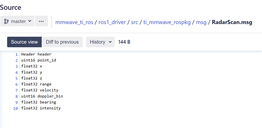

    I would like to analyze the point cloud data obtained from 3D People Tracking in Industrial Visualizer.
    In the saved JSON file, there is an entry called "pointCloud." Does this refer to the point cloud data?
    Additionally, I would like to understand the meaning of the following values:
    "pointCloud": [
                            0.4328698122151555,
                            1.4286174734507147,
                            1.7270855280880597,
                            0.06972000186215155,
                            32.63999927043915,
                            0.0,
                            255.0
    Could you please explain what these values represent?
    I couldn't find any documentation to refer to.
  • As mentioned before, all messages are ROS's output structure representing one of the many TLVs the Radar outputs.
    https://dev.ti.com/tirex/explore/node?node=A__AaagUFIod1NcG0sE-noAfw__radar_toolbox__1AslXXD__LATEST
