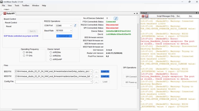

I have a connection problem with my new AWR2243 radar.
The board disconnects repeatedly with the following message in the 921600 baud rate:
[14:21:31] [RadarAPI]: Warning: Trying to connect with baudrate 921600
[14:21:34] [RadarAPI]: Warning: Connected with baudrate 115200
[14:21:34] [RadarAPI]: Warning: TOP_CTRL:EFUSE_OVERRIDE_RS232_CLKMODE value: 0
[14:21:34] [RadarAPI]: Warning: RS232_BITINTERVAL value: 0 input: 227552299
[14:21:35] [RadarAPI]: Warning: Disconnected existing BaudRate
[14:21:35] [RadarAPI]: Warning: Trying to connect with baudrate 921600

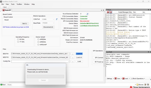

In the 115200 baud rate, it connects, but the device is not recognized and the BSS and MSS loading popup page freezes:
ar1.Connect(6,115200,1000)
[15:33:05] [RadarAPI]: ar1.Calling_IsConnected()
[15:33:07] [RadarAPI]: Part number of the device = 0x0
[15:33:07] [RadarAPI]: Device type = TEST
[15:33:07] Device Status : UnDetDe/QM/SOP:Inv/ES:0.0
I have set SOP0=1, SOP1=1, and SOP2=1. I have the following packages installed:
- ti_emupack_setup_9.2.0.00002_win_64
- mmwave_studio_03_01_04_04_win32
What might be the problem?
