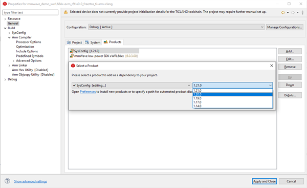

    I tried to give CCS v12.8.1 the path to SysConfig v1.22. It seems to have recognized the tool and shows the path under installed products, but while building CCS still seems to use SysConfig v1.21.
    I realized that within the tools folder of MMWAVE L SDK, there are also some SysConfig device files for XWRL684X.
    So I tried to copy those into the utils/sysconfig_1.21.0 folder in the CCS folder and triggered a release build again.
    This is the output I got this time:
  • Hey Matthias,
    We'll need more time to look into the Uniflash issue, but for the SysConfig issue, please use SysConfig 1.20 instead. You can switch the SysConfig used when building a project by right-clicking on the project name in Project Explorer -> Properties -> General -> Products -> SysConfig -> Edit and then change to 1.20.

  • Hey Kristien,
    I apologize as I should've asked you in my previous reply, but could you send a screenshot of what error is being thrown in CCS when attempting to use SysConfig 1.20? I haven't seen any other issues with SysConfig other than the GPN issue seen when using later versions of SysConfig.
    You were right. Looks like there was an issue due to having multiple versions of SysConfig installed.
    I have uninstalled all other versions than 1.20 and now I am at least able to open the example.syscfg file.
    Still I am not able to build the mmwave demo project.
    Looks like CCS is not recognizing the XWRL68xx device, eventhough I have copied the xml file to targetdb/devices and added the target configuration file.
    Whenever I try to do anything within the project properties, I get the following error message dialog:
    BR
    Matthias
  • Hey Matthias,
    Are you using the version of CCS that you were able to successfully add the XML file data? If you were able to import the project, then CCS shouldn't be throwing the device error shown in your screenshots. Based on previous replies, it sounds likes 12.8.1 is the version of CCS that currently recognizes the device information, but I would confirm if that is the case.
    Kristien
  • Hey Kristien,
    no, actually I tried to uninstall and reinstall CCS and the related tools a couple of times and switched back to v12.7.1, after facing these issues.
    The imported project remained in the eclipse/CCS workspace though and was therefore immediately displayed after opening CCS.
    It looks like the toolchain with CCS v12.7.1 and SysConfig v1.20.00 is working after I updated the Compiler Tools and deleted and reimported the CCS project (since it was giving a warning that the project in workspace was created with a newer version of CCS).
    Both build targets (debug and release) finished successful and all problems/warnings in CCS vanished.
