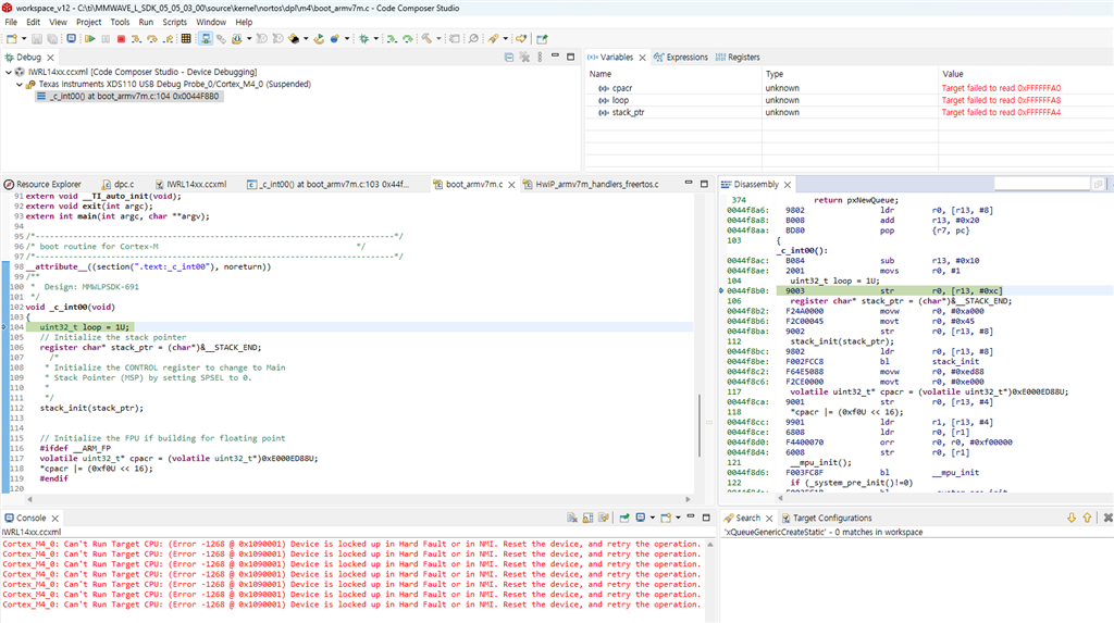

Additional (The section where the hard fault occurs is shown in the image below.)
Thank you.
  • Additionally, I used CCS for debugging by referring to the following URL:
    URL: https://dev.ti.com/tirex/explore/content/radar_toolbox_2_30_00_12/software_docs/using_ccs_debug.html
    After completing the steps up to "3.2 Connect to EVM using Target Configuration File and Load Binaries", the program enters the HwiP_hardFault_handler() function defined in Hwip_armv7m_handlers_freertos.c:
    void HWI_SECTION HwiP_hardFault_handler()
    volatile uint32_t loop = 1;
    while(loop)
    In the Console window, the following error occurs:
    Cortex_M4_0: Can't Run Target CPU: (Error -1268 @ 0x1090001) Device is locked up in Hard Fault or in NMI. Reset the device, and retry the operation. If error persists, confirm configuration, power-cycle the board, and/or try more reliable JTAG settings (e.g., lower TCLK). (Emulation package 12.7.0.00105)
  • Hi
    There is no relation between XDS110 detection with the CCS project being built. In the prebuilt image, release configuration is provided which is the reason for difference in the size of the appimage that you are seeing.
    What do you mean by XDS110 is not detected? Are you referring to the COM ports in the device manager? If you are able to connect the JTAG as shown in the picture above, it means XDS110 is active and detected correctly
    Before you connect the JTAG and load the CCS project generated .out, have you flashed empty.release.appimage from <MMWAVE_SDK5_INSTALL_DIR>\examples\empty\xwrL14xx-evm\m4fss0-0_freertos\ti-arm-clang
    After you have flashed  empty.release.appimage, you need to configure the IWRL1432 EVM in functional mode and reconnect the EVM. Are these steps followed before connecting to JTAG?
    After connecting CM4 through JTAG, you need to perform Run->Reset->CPU Reset before loading the .out
    Let me know if it works correctly after following these steps
    => I had not performed that sequence initially, but after doing so, I confirmed that it operates correctly.
