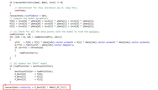

  • Hello.
    Thank you for your answer.
    In my understanding best_point[1] and best_point[2] represent the velocity information of the other two tx-antennas. The velocity is not projected on the y-component yet. So it´s the raw velocity information from the antennas point of view.
    Is that correct?
    I noticed that the variable "velocity" which is contained in the struct "MmwDemo_Ego_Velocity" is defined as a float.
    In my understanding it would not be possible to consider all three best_points in "ransacStats->velocity" without redefining velocity as an array.
    But if doing so, I have to correct the whole code, so that velocity is handled as an array..
    Is there an easier way and am i missung something?
    Thank you for your time!
  • Hello.
    If by best_point you are referring to the P_best[0, 1, 2], those are the polynomial parameters for best-fit equation.  P_best[0] is used for the velocity as it represent the velocity when the azimuth is 0(driving the x and x^2 components in the polynomial to 0).  That is why a single velocity is returned and why ransacStats->velocity is not an array.

  • Okay I understand that, but the answer didn´t really help me out because the situation is as i expected and not solved.
    So there are still a few questions left:
     1. It´s still not clear what p_best[1] and p_best[2] represent - is it the velocity measured by the other two antennas?
     2. If so, how could I include them in velocity?
     3. By redefining velocity as an array? Or is there an easier way, which doesnt require to adapt the whole process?
    Thank you for your effort and your time!
  • Hello.
    I think you are misunderstanding the use of the RANSAC-LSQ algorithm.  This algorithm generates a polynomial that describes the average velocity(singular) of the inlier points in the pointcloud with respect to the angle from the device, not individual velocities.  The p_best are coefficients to best describe this polynomial.  If you want to look at the velocity at a different angle, you will plug in that angle and compute the sum of products(p_best[2] * azimuth^2 + p_best[1] * azimuth + p_best[0]).  Because we only care about the velocity with respect to boresight on the sensor, we use p_best[0] as it is equivalent to plugging in zero; if you wanted to use p_best[2]/[1], it would be in the case that you want to look at it from an angle.  At the end of the day, the result from the RANSAC will always be a singular velocity, never an array.
