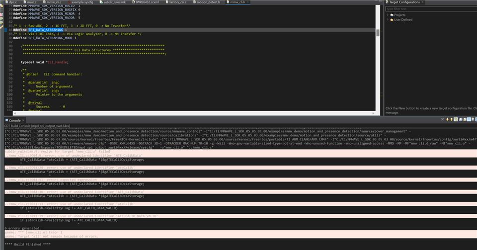

  • Hi Vignesh,
    Thank you for your reply. I've found the macros. However upon building there are errors (see screenshot below). I wasn't able to find the structure ATE_calibData and I wasn't able to see from where this extern is being called from: "extern uint8_t gATECalibDataStorage[]" (mmw_cli.c, line 125) Are they supposed to be in a header file? And if so could you tell me in which header file it should be? I am on CCS 12.8.0.
    - Rene
  • Hi Rene,
    Please give me a few days to look into this issue a little deeper but in the mean time you can make these updates-
    added the following to to mmw_cli.c:
    extern uint8_t gATECalibDataStorage[];
    uint8_t gATECalibDataStorage[(ATE_CALIB_DATA_LENGTH + 4)] __attribute__((aligned(8))) = {0};
    added the following to mmw_cli.h:
    #define ATE_CALIB_DATA_LENGTH (uint8_t)(128U)
    #define ATE_CALIB_DATA_VALID 0x0U
    typedef struct ATE_CalibData_s
    /* Flag to indicate the calibration data is valid */
    uint32_t validityFlag;
    /* Factory Calibration data */
    uint8_t factoryCalData[ATE_CALIB_DATA_LENGTH];
    } ATE_CalibData;
    This will help with your current issues but I suspect you will see other issues while building your project. I will contact you again in a few days letting you know what I find. Thank you for your patience!
    Vignesh K.

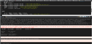

  • Hello Vignesh,
    as you already suspected the previous error is cleared, however the current issue seems to be due to memory constraints.
    Thank you for your support,
    - Rene
  • Hey Rene,
    It looks like we are seeing all these issues because there is a mismatch in SDK's between this example project and the latest SDK which we have downloaded. I won't be able to look into this until early next week but if you have time, I would suggest downloading SDK 5.4.0.01 and attempting to run the example there after changing the #define SPI_DATA_STREAMING to 1 and SPI_DATA_STREAMING_MODE to 1 if needed. And any of the other changes that I mentioned.
    No problem if you can't validate this yourself but I will get back to you early next week with some updates on this issue.
    Vignesh K.
  • Hi Vignesh,
    installing SDK 5.4.0.01, re-importing the example into CCS and setting SPI_DATA_STREAMING and SPI_DATA_STREAMING_MODE to 1 resolved the issue. I was able to read the raw data file with MATLAB and have it processed accordingly.
    All the best,
    - Rene
