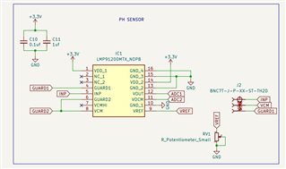

I am using the LMP91200 AFE for 2-electrode pH sensor communication in my project, and I am interfacing it with a PIC controller. While I am receiving some data from the sensor, the issue is that the data is inconsistent. Every time, it gives different values without any change in the pH solution.

    I may be helpful to provide us a schematic and layout of your PCB that uses LMP91200. My suspicion is that there is leakage interfering with the pH measurement. Are you using a guard ring with pins GUARD1 and GUARD2?

    Thanks for your suggestion. Yes, I have connected GUARD1 and GUARD2 to the BNC connector as part of the guard ring implementation. Please find the schematic and layout I have attached below for your review.
    Regarding the Vref (pin 9), I’ve also connected a potentiometer to allow for adjustment of the reference voltage to ensure accurate pH measurements.
    I’m still getting inconsistent values, and I think it might be due to leakage or an issue with grounding or signal conditioning. I’d appreciate any advice or suggestions after looking at the schematic.

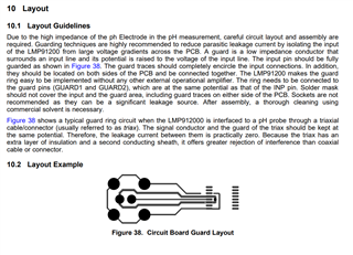

    You may want to try using a triax connection, and following this layout:
    There is a second guard ring around the GUARD1 and GUARD2 pins.
    Regarding you layout, is there solder mask over the pH input signal? That will introduce leakage. Do not cover the guard ring with solder mask either.
    Cleanliness is a big source of leakage as well. Is there corrosion on the traces, are they gold plated (gold plated wont corrode)? Was the PCB washed thoroughly?
    -Alex Thompson

    Most likely that unwanted data is coming from leakage on your PCB or design. I would try using the pH sensor in a pH neutral environment, and you should be getting 0mV on the output. If you aren't, then there are leakages that must be fixed.
    I think that BNC configuration will work, having the triax at the LMP91200 will help reduce leakages.
