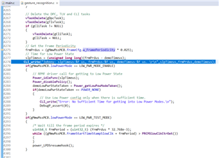

            // Get the Frame Periodicity
            frmPrdus = (gMmwMssMCB.frameCfg.w_FramePeriodicity * 0.025);
            // Time for Low Power State
            slpTimeus = (unsigned long long)(frmPrdus - demoTimeus);
            if(gMmwMssMCB.lowPowerMode == LOW_PWR_MODE_ENABLE)
                // RPMF driver call for getting to Low Power State
                Power_idleFunc(slpTimeus);
                Power_disablePolicy();
                demoLowPwrStateTaken = Power_getLowPowModeTaken();
                if(demoLowPwrStateTaken == POWER_NONE)
                    // Use Low Power config only when there is sufficient time.
                    CLI_write("Error: No Sufficient Time for getting into Low Power Modes.\n");
                    DebugP_assert(0);
            if(gMmwMssMCB.lowPowerMode == LOW_PWR_TEST_MODE)
                /* Wait till the frame period expires */
                uint64_t frmPeriod = (uint32_t) (frmPrdus * 32.768e-3);
                while ((gMmwMssMCB.frameStartTimeStampSlowClk + frmPeriod) > PRCMSlowClkCtrGet())
                power_LPDSresumehook();

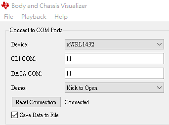

    In addition, according to the original sample program, I set lowPowerCfg to 0, and the system could not run normally.
    I will test how long it takes to capture a CAN transmission.
  • Hey Johhny,
    See my responses below:
    Do you mean "frameIdleTime"?
    No, frameIdleTime is an estimation of the amount of time spent outside of chirping which does include processing time but also inactive time that may be spent in low power mode. The interframeProcessingTime is the measured processing time and is not an estimate.
    Understood, in that case, I would recommend using the Radar Toolbox Applications Visualizer under <RADAR_TOOLBOX_INSTALL_DIR>/tools/visualizers/Applications_Visualizer/Body_And_Chassis_Visualizer/ and enabling the feature to Save Data to File. You can then keep lowPowerCfg set to 1 but ensure the last parameter of guiMonSel is set 1 so that the stats TLV is outputted. This will be saved to a binData folder.
    Kristien

  • I followed the suggested location but got an error message
    "Error: No Sufficient Time for getting into Low Power Modes."
    Check the "demoTimeus" value.
    Normal state :
    Johnny: slpTimeus:0.000000 us, frmPrdus:70000.000000 us, demoTimeus:41480.000000 us.
    Johnny: slpTimeus:0.000000 us, frmPrdus:70000.000000 us, demoTimeus:41297.000000 us.
    Johnny: slpTimeus:0.000000 us, frmPrdus:70000.000000 us, demoTimeus:41327.500000 us.
    Johnny: slpTimeus:0.000000 us, frmPrdus:500000.000000 us, demoTimeus:41144.500000 us.
    Johnny: slpTimeus:0.000000 us, frmPrdus:500000.000000 us, demoTimeus:12474.500000 us.
    Johnny: slpTimeus:0.000000 us, frmPrdus:70000.000000 us, demoTimeus:12474.500000 us.
    Johnny: slpTimeus:0.000000 us, frmPrdus:70000.000000 us, demoTimeus:41175.000000 us.
    Open App_mcanTxRx() state :
    Johnny: slpTimeus:0.000000 us, frmPrdus:500000.000000 us, demoTimeus:12932.000000 us.
    Johnny: slpTimeus:0.000000 us, frmPrdus:500000.000000 us, demoTimeus:259738.000000 us.
    Johnny: slpTimeus:0.000000 us, frmPrdus:500000.000000 us, demoTimeus:308507.500000 us.
    Johnny: slpTimeus:0.000000 us, frmPrdus:500000.000000 us, demoTimeus:259555.000000 us.
    Johnny: slpTimeus:0.000000 us, frmPrdus:500000.000000 us, demoTimeus:308294.000000 us.
    Johnny: slpTimeus:0.000000 us, frmPrdus:500000.000000 us, demoTimeus:259341.500000 us.
    Johnny: slpTimeus:0.000000 us, frmPrdus:500000.000000 us, demoTimeus:309056.500000 us.
    Johnny: slpTimeus:0.000000 us, frmPrdus:70000.000000 us, demoTimeus:12932.000000 us.
    Johnny: slpTimeus:0.000000 us, frmPrdus:70000.000000 us, demoTimeus:288316.500000 us.
    I tried adjusting "frameCfg 2 0 200 128 70 0 \n\r", The fifth parameter did not improve.
    12932 - 12474.5 = 457.5 us (the CAN transmit time)
    The CAN bus processing procedure does not seem to have a fixed time.
