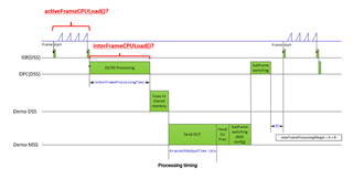

AWR2944EVM: The value of interFrameCPULoad & activeFrameCPULoad in DPC
Part Number: AWR2944EVM
Hi
 For below 2 functions, are activeFrameCPULoad() and interFrameCPULoad() the loading I marked as Red in the picture?
static void MmwDemo_DPC_ObjectDetection_processFrameBeginCallBackFxn(uint8_t subFrameIndx)
gMmwDssMCB.dataPathObj.subFrameStats[subFrameIndx].interFrameCPULoad = TaskP_loadGetTotalCpuLoad() / 100;
TaskP_loadResetAll();
static void MmwDemo_DPC_ObjectDetection_processInterFrameBeginCallBackFxn(uint8_t subFrameIndx)
gMmwDssMCB.dataPathObj.subFrameStats[subFrameIndx].activeFrameCPULoad = TaskP_loadGetTotalCpuLoad() / 100;
BRs
Bruce
