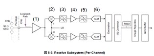

The AWR2243 receiving subsystem consists of four parallel channels.
One receiving channel is configured as shown in the diagram below.
Please tell me the names of the components that make up (1) to (6) in the diagram.
(1)LNA, (2)Mixer, (3)HPF, (4)Rx Gain, (5)LPF, (6)ADC
