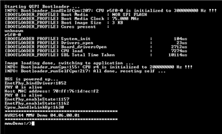

  • Hi Shruti,
    Thanks for the suggestion. Here I updated the configure, and the console is alive after the sensorStart. (the 3rd parameter of the frameCfg, number of loops should no less than 4; the 3rd parameter of the procChainCfg should no larger than the chirps)
    But the Wireshark on PC still hasn't show anything.
    ( I have tested this configure on the 1000Base-T1 2544EVM board, and everything works fine.  The data rate is 4 chirps x 256 samples x 10Hz)

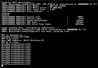

  • Hi Shruti,
    I did another change on the AWR2544LOPEVM: Install R258 to pull up LED_0, which can configure the 100BASE-T1 to master mode through hardware bootstrap.
    However I got the following output on the console (the 100Base-T1 converter on slave mode, which means the DP83TC812 is on master mode):
    Looks like the link keeps up and down. Any suggestions?
    Kaiyu Huang
