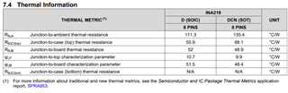

I am requesting the values for the
1. Junction to Case Thermal Resistance (RθJC)
2. Junction to Board Thermal Resistance (RθJB)
-for the TMP442ADCNR.
These values with assist in our thermal analysis. Thank you.

Hello Quek,
I will need to ask the packaging team for the exact answer, but a good rough estimate would be to use the values with a device with a similar package designator.
INA219 Zerø-Drift, Bidirectional Current/Power Monitor With I2C Interface datasheet (Rev. G)
