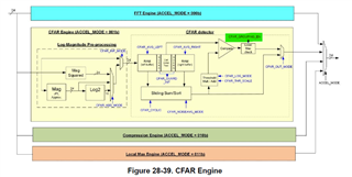

In cfarpro (mmwave_mcuplus_sdk_04_04_01_02/ti/datapath/dpu/cfarproc/docs), there is a configuration parameter hwaParamCfg.accelModeArgs.cfarMode.peakGroupEn. However, in the HWA-CFAR data flow, there is no introduction or explanation regarding the peakGrouping process.
Does DPU_CFARProcHWA_process perform peakGrouping? If so, in which part of the process is it implemented?
