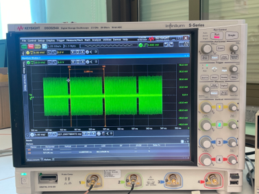

I faced a problem with the clock drift, I used the receiver as well as the down-converter and connected it to the oscilloscope, but seems like the frame periodicity is not exactly the same as the periodicity I set. Also, the frame time drift is also changing with time, for example, the setting is 10ms, but actually, it is 10.00055ms from the oscilloscope, and later it becomes 10.00065ms. And the change of the frame periodicity doesn't change linearly with time.

    Could you please share how are you doing the measurements?
    Are you using a different receiver antenna and down-converting the RF signal?
    What are you plotting in oscilloscope, the analog signal?
    Swarnendu
  • Hello Swarnendu,
    Yes, I am using a different receiver antenna and a downconverter mixed with a 60Ghz signal, so I will get a 0-2GHz signal after the converter. Yes I am plotting analog signal. Something like what the figure is showing.
    Bei
  • Hi Bei,
    Understood.
    Actually, it is not clock-drifting that you are seeing in the event of frame time changing by ~550ns. The Synthesizer and APLL requires some time to re-start. Such high refresh rate (10ms of frame time), and interframe time as low as 788us might not be enough for that, hence, the frame timer will adjust the startup time of the APLL and SYNTH. Therefore, you might see little drift in the frame time. For the device, it is unrealistic to have control over this.

    Also, could you please share a snap-shot of the analog signal you are receiving? I cannot see the previous image clearly for the low resolution.
    Swarnendu

    I believe the timing should be quite accurate since we use it extensively for 60GHz experiments. I’m currently checking the specification and will get back to you once I have it.  Also, I’m rather certain the issue stems from the radar itself. I tested with two radars operating at the same frame period, positioned in front of each other. If the frames were truly synchronized, the interference signal from one radar should appear in the same chirp for each frame of the other. However, I observed the interference signal showing up in different chirps, which suggests some frame period inaccuracy from the radar.
    Attached is the figure you requested, hope this is more clear now.
    Bei
  • Hello Bei,
    Thanks for sharing the image.
    Observing parallel interference with LOs not synced together would have multiple differences between them. Hence, it could be difficult and might not provide absolute confirmation of frame time delay.
    In the scope I am seeing 11.889ms which is similar to the frame time that has been set in the configuration (11.888ms).
    Ideally the frame time error will depend on the XTAL ppm error. The 40MHz crystal that has been used in IWR6843ISK has a tolerance of +/-50ppm. With this, a ~0.5us drift for a 10ms frame period is expected. This is not arising from the chirp, rather this is because of the frequency tolerance of the XTAL.
