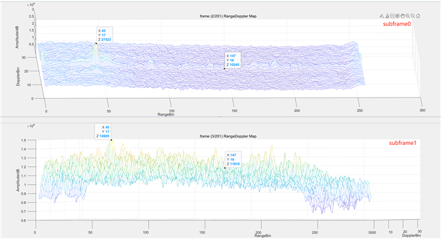

In the darkroom test, the target was at 21m, and radar RD data was collected. Using Matlab to plot, Z in the figure represents the amplitude;it was found that there was a significant difference in signal-to-noise ratio between the two sub frames;
What is the cause and how to locate and analyze the problem
    Did you configure the chirps for both the devices? Are you testing with a stationary target? Since the detection is not at zero doppler bin, I think that it's a moving target. Can you perform the same experiment with stationary target? Also do the plots correspond to the subframes of a single frame or they are of different frames?
    Samhitha
  • 1、Did you configure the chirps for both the devices?
    yes;
    2、Are you testing with a stationary target?
    I use the radar target simulator  to test;
    3、Since the detection is not at zero doppler bin, I think that it's a moving target. Can you perform the same experiment with stationary target?
    I also used a stationary target for the test, and the phenomenon was the same.
    4、Also do the plots correspond to the subframes of a single frame or they are of different frames?
    In the picture above, the RD maps of subframe 1 and subframe 2 within the same frame are shown.

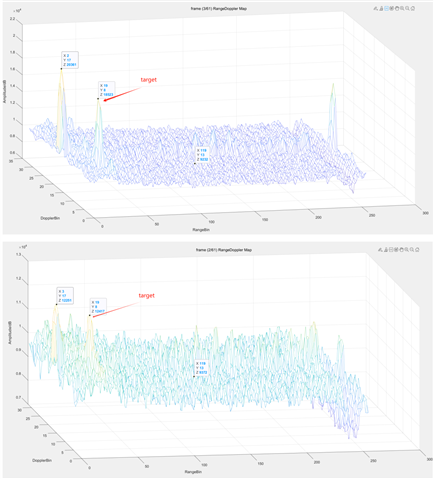

  • Hi Miles,
    Is the runtime calibration enabled? Can you check the behavior across all the frames? Is the signal strength different for subframe 1 and subframe 2 across the frames? Can you perform this experiment with stationary target and provide the plot to analyze the behavior across the frames?

  • The picture shows the RD maps of subframe 0 and subframe 1 for stationary targets in the same frame.

  • Hi Miles,
    Based on my understanding of the code, it appears that this runtime calibration is specifically pertinent to the AWR2243 chip and seemingly unrelated to subframe 0 and subframe 1
    Firstly, since you are using two-chip cascade, each of the devices are allowed to calibrate independently. It's possible that each of the devices perform calibration at different times based on the temperature of that particular device. So, I wanted to confirm if the runtime calibrations are performed or not. If runtime calibrations are performed, how are you triggering the calibrations for each device?
    For details about calibrations, did you get a chance to look at the documents shared in the previous response?
    Can you also try to use same profile for all subframes and perform the experiment? Since there is no change in any parameters in both the profiles, you should be able to use same profile for both the subframes for this experiment.
    Also, if possible, can you share a plot of signal strength of each subframe across all the frames?
    Is the signal strength of the target detected in Subframe 0 and Subframe 1 vary across all the frames? Did you perform the same test with other EVM?
