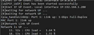

We could have established 100Mbps ethernet communication with PC and EVM then we are trying to do with 1Gbps. To do that we modify "enet_cpsw_tcpserver" by referring SDK user guide 3.9.3.4
(file:///C:/ti/mmwave_mcuplus_sdk_04_07_00_01/mmwave_mcuplus_sdk_04_07_00_01/docs/mmwave_mcuplus_sdk_user_guide.pdf)
According to the debug log, I think we could Linkup with 1Gbps but ping did not work and cannot communicate.
Would you please advise me to resolve this? And please correct me if we miss something or misunderstanding.
