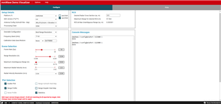

  I flash "out_of_box_2944.appimage" in radar_toolbox_2_30_00_12\source\ti\examples\Out_Of_Box_Demo\prebuilt_binaries and use web demo visualizer to show detection result. But the visualizer show this error message "SDK input version [major,minor]=[0,8] not matching [4,4] reported by target." Can you please help to check the reason?
