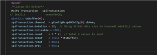

My requirement is to send level sensing data to an external MCU using SPI. I am currently working with the IWRL1432 BOOST board. I imported the source code into CCC Studio, modified it by enabling the MCSPI driver, making changes to the dpc.c file, and then flashed it onto the board using the mmWave Radar Visualizer.
Additionally, I set the S1.6 pin to high on the board. However, when I checked the SPI_CLK pin on the J header, I didn't observe any signal. I am attaching pictures of the source code modifications below.
How should I proceed next to ensure my code is working correctly? Any suggestions?

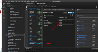

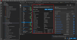

    McSPI and I2C should not be enabled together in syscfg. You should either completely remove I2C and setup McSPI in syscfg, or you should manually setup McSPI in the code. We have a raw ADC data capture using McSPI in the demo, for that we would have manually added the McSPI configuration in the code.
    Please have a look at that before proceeding further.

  • Thanks for your response, Sharan S S.
    I deleted the I2C driver in the SysConfig file, but it caused some errors. I don’t want to follow this approach. Instead, I want to manually set up McSPI in the code. Could you share the necessary code for that and let me know which file I should add it to?

    The McSPI source is already present in mmw_cli.h and mmw_cli.c for SPI Raw ADC Capture, you can modify the parameters if required and proceed.
    You can also try capturing the ADC Data through SPI lines with your MCU just to confirm if the transfer is working. Then you can modify to send out the actual level sensing data instead of Raw ADC.

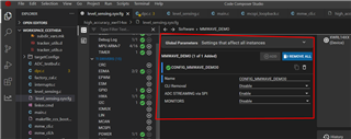

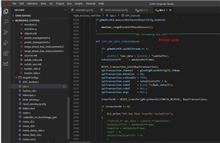

    1. I enabled ADC streaming via SPI in the SysConfig file.
    2. I added the macro SPI_ADC_DATA_STREAMING = 1 in a header file.

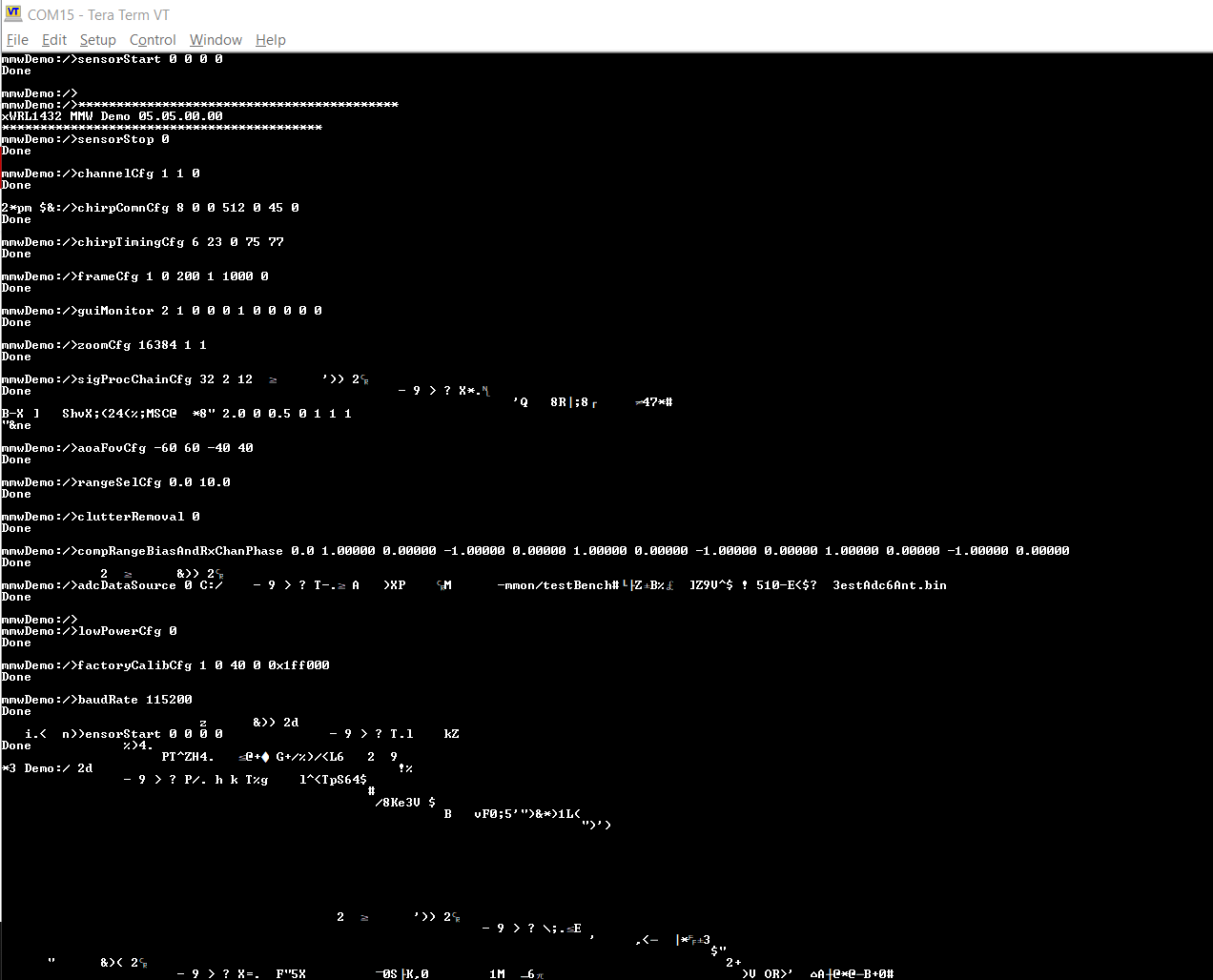

    3. I connected to Tera Term and sent the configurations, but I received garbage data in the terminal window.

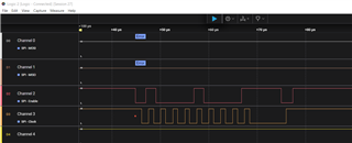

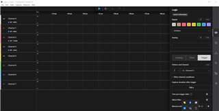

    4. To debug, currently i don't have FTDI cable, so I connected a logic analyzer to the J2 pins, i got Error message in MOSI and MISO channels
      My requirment is to send the data to another MCU using SPI.
    I will attach the relevant pictures for reference.

    Please go over the configurations correctly. Level Sensing demo only supports FTDI based data capture, for Logic Analyzer based capture some McSPI parameters are supposed to be modified.
    Please look into \radar_toolbox_2_30_00_12\source\ti\examples\Fundamentals\xWRL6432_Raw_Data_Over_SPI, source code for Logic Analyzer based configurations. There are some requirements in the cfg as well for the capture to go through. Please go over the docs present in the above directory.

  • Hello Sharan,
    I reviewed your example source code and opened it in CCS, but I encountered errors while building and one more things is the example is for the IWRL6432, while my board is the IWRL1432.
    so i tried this Method

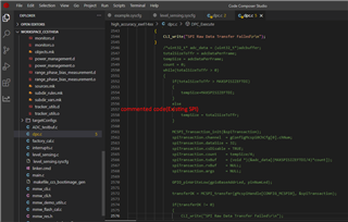

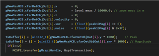

    I copied the SPI logic analyzer code from the example and made some modifications to my level-sensing code:
    1. Enabled ADC streaming via SPI in the SysConfig file.
    2. Pasted the copied code  into my dpc.c file and commented out the existing SPI code.
    However, I did not get the MOSI signal in the logic analyzer, please give me the step by step  procedure for sending data to ext MCU by SPI

    There could be a variety of reasons for this, you should configure McSPI for logic analyzer properly. In the code, SPI_DATA_STREAMING = 2 corresponds to McSPI configuration for LA. Also, please ensure that your Logic Analyzer supports a higher sampling rate.
    In the meantime, let me formulate a step by step guide to do the capture. I'll get back to you in a couple of days with the entire steps required.

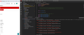

  • Hello Sharan,
    I enabled and modified the macro in the example code, but I am still encountering errors. I also checked the macro in the level sensing code but couldn't find the macro.
    Anyway, I will wait for the step-by-step procedure. Thanks a lot for providing this!

    Can you view the clock output signals in LA? Can you share me your modified code?
    Sharan

        #if (SPI_ADC_DATA_STREAMING==1)
        MCSPI_Transaction   spiTransaction;
        int32_t             transferOK;
        uint32_t totalSizeToTfr,tempSize;
        uint8_t count;
        #endif
        #if (CLI_REMOVAL == 0 || TRACKER_CLASSIFIER_ENABLE == 1)
        DPU_uDopProc_TrackerData trackerData;
        #endif
        /* give initial trigger for the first frame */
        errCode = DPU_RangeProcHWA_control(gMmwMssMCB.rangeProcDpuHandle,
                     DPU_RangeProcHWA_Cmd_triggerProc, NULL, 0);
        if(errCode < 0)
            CLI_write("Error: Range control execution failed [Error code %d]\n", errCode);
        if (gMmwMssMCB.sigProcChainCfg.motDetMode == 1)
            enableMajorMotion = 1;
            enableMinorMotion = 0;
        else if (gMmwMssMCB.sigProcChainCfg.motDetMode == 3)
            enableMinorMotion = 1;
        else
            enableMajorMotion = 0;
        if (enableMajorMotion)
            result->rngAzHeatMap[MMW_DEMO_MAJOR_MODE] = (uint32_t *) gMmwMssMCB.detMatrix[MMW_DEMO_MAJOR_MODE].data;
        else
            result->rngAzHeatMap[MMW_DEMO_MAJOR_MODE] = NULL;
        if (enableMinorMotion)
            result->rngAzHeatMap[MMW_DEMO_MINOR_MODE] = (uint32_t *) gMmwMssMCB.detMatrix[MMW_DEMO_MINOR_MODE].data;
        else
            result->rngAzHeatMap[MMW_DEMO_MINOR_MODE] = NULL;
        result->objOut = gMmwMssMCB.dpcObjOut;
        result->objOutSideInfo = gMmwMssMCB.dpcObjSideInfo;
        while(true){
            memset((void *)&outParms, 0, sizeof(DPU_RangeProcHWA_OutParams));
            retVal = DPU_RangeProcHWA_process(gMmwMssMCB.rangeProcDpuHandle, &outParms);
            if(retVal != 0){
                CLI_write("DPU_RangeProcHWA_process failed with error code %d", retVal);
                DebugP_assert(0);
            /* Procedure for range bias measurement and Rx channels gain/phase offset measurement */
            if(gMmwMssMCB.measureRxChannelBiasCliCfg.enabled)
                mmwDemo_rangeBiasRxChPhaseMeasure();
            /***************************ADC Streaming Via SPI***********************************************************/
                if( gMmwMssMCB.spiADCStream == 1)
                    uint32_t *adc_data = (uint32_t *)adcbuffer;
                totalSizeToTfr     = adcDataPerFrame;
                MCSPI_Transaction_init(&spiTransaction);
                spiTransaction.channel   = gConfigMcspi0ChCfg[0].chNum;
                spiTransaction.dataSize  = 32;
                spiTransaction.csDisable = TRUE;
                spiTransaction.count     = totalSizeToTfr / 4;
                spiTransaction.txBuf     = (void *)(&adc_data[0]);
                spiTransaction.rxBuf     = NULL;
                spiTransaction.args      = NULL;
                transferOK = MCSPI_transfer(gMcspiHandle[CONFIG_MCSPI0], &spiTransaction);
                if (transferOK != 0)
                    CLI_write("SPI Raw Data Transfer Failed\r\n");

                level_meas = (uint32_t)roundf(outParmsZoomproc.zoomRangeMeas * 10000); // zoom meas in m rounded to fourth digit i.e., 0.1mm
                gMmwMssMCB.cfarDetObjOut[i].x        = 0;
                gMmwMssMCB.cfarDetObjOut[i].y        = level_meas / 10000.0; // zoom meas in m
                gMmwMssMCB.cfarDetObjOut[i].z        = 0;
                gMmwMssMCB.cfarDetObjOut[i].velocity = 0;
                gMmwMssMCB.cfarDetObjOut[i].snr      = (float)(peak1DMag[i] >> 6);
                gMmwMssMCB.cfarDetObjOut[i].noise    = (float)(peak1DMag[i] & 0x3f);

    Hii Sharan,
    I made modifications in only two areas:
    1 Enabled ADC_Streaming in the sysconfig file under the mmWave demo section.
    2 Modifications line starts from  2525 in the dpc.c file.
    I’m attaching the Logic Analyzer (LA) settings and the modified code in dpc.c file.
    Thanks && Regards,
    Amara Rakesh
    Is your LA max sampling rate 24 MS/s? If so, the capture would definitely be incorrect.
    I would suggest you try out a higher sampling rate. I'll send out the steps in the meantime.
    Sharan
  • Hello Sharan,
    Currently, I don’t have access to a high-sampling logic analyzer, so I connected the external MCU and CRO for testing. However, I did not receive any signal, which suggests I might have missed some steps.
    I’m waiting for your step-by-step procedure to send the level sensing data to the external MCU. The relevant data is present in the dpc.c file:
    Looking forward to your guidance.
