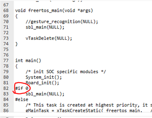

  • I refer to "radar_toolbox_2_30_00_12\source\ti\examples\Automotive_HandsFree_Access\Hands_Free_Access\Kick_to_Open" and "MMWAVE_L_SDK_05_05_03_00\examples\drivers\boot\sbl" example code.
    And add SBL function to Kick_to_Open project.
    The application image(any image) has been pre-burned in Partition 2, and the log will be displayed in the terminal when it is turned on.
    If the following main code is executed in the main task, it will not switch to Partition 2 for booting, and no log will be displayed in the terminal.

    //void gesture_recognition(void *args);
    void sbl_main(void *args);
    void freertos_main(void *args)
        //gesture_recognition(NULL);
        sbl_main(NULL);
        vTaskDelete(NULL);
    int main()
        /* init SOC specific modules */
        System_init();
        Board_init();
    #if 0
        sbl_main(NULL);
    #else
        /* This task is created at highest priority, it should create more tasks and then delete itself */
        gMainTask = xTaskCreateStatic( freertos_main,   /* Pointer to the function that implements the task. */
                                      "freertos_main", /* Text name for the task.  This is to facilitate debugging only. */
                                      MAIN_TASK_SIZE,  /* Stack depth in units of StackType_t typically uint32_t on 32b CPUs */
                                      NULL,            /* We are not using the task parameter. */
                                      MAIN_TASK_PRI,   /* task priority, 0 is lowest priority, configMAX_PRIORITIES-1 is highest */
                                      gMainTaskStack,  /* pointer to stack base */
                                      &gMainTaskObj ); /* pointer to statically allocated task object memory */
        configASSERT(gMainTask != NULL);
        /* Start the scheduler to start the tasks executing. */
        vTaskStartScheduler();
        /* The following line should never be reached because vTaskStartScheduler()
        will only return if there was not enough FreeRTOS heap memory available to
        create the Idle and (if configured) Timer tasks.  Heap management, and
        techniques for trapping heap exhaustion, are described in the book text. */
        DebugP_assertNoLog(0);
    #endif
        return 0;
     *************************** Function Definitions *************************

    bootload_qspi() cannot be executed in main task? Why?
  • I currently have no other ideas to solve this problem, do you have any other suggestions? Thanks!
  • Do you have any other suggestions or other approaches? Thanks!
  • Hey Johnny,
    Thank you for your patience. Could you try your example following the steps outlined here
    Do I understand correctly that you are using CCS to implement this? I think it may be easier to use UNIFLASH and just flash the device with all the correct images at once instead.
    I will get back to you on why the bootload_qspi function may not be working. I have to look further into this.

  • The current problem is as shown in the figure below. Setting "#if 1" works normally, but setting "#if 0" does not work?
    The secondary boot loader cannot be executed in a freeRTOS task?

    Thanks for your response. I am trying to understand your issue better and I want to know why you want to use FreeRTOS for this SBL image. Is there a reason you want FreeRTOS support for the SBL? Why did you remove the download portion of the sbl_main?
    We don't support a FreeRTOS SBL, the reason for this is that there is a lot of overhead that needs to be de-initialized and re-initialized when switching over from the SBL example to be FreeRTOS compatible which ends up being difficult to implement.
    Please try using the SBL as is, outlined here.

  • This is the question at the beginning of the title."Secondary Boot Loader cannot be executed in a task in freeRTOS."
  • Hi Johnny,
    We understand your interest in using FreeRTOS with our SBL example. However, as previously communicated, we do not officially support a FreeRTOS implementation for the secondary bootloader. We kindly suggest using the SBL noRTOS example as is. While we cannot provide direct support for integrating FreeRTOS with the SBL example, our team would be happy to assist you with any other inquiries or issues related to our officially supported configurations and examples. Please feel free to open a new thread or contact us if you have any further questions, otherwise I will be closing out this thread.
