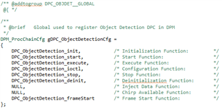

For DPC_ObjectDetection_frameStart(), it will be invoked by Frame or SubFrame event?
For Advanced Frame config and there are 2 subFrames, it will be invoked by SubFrame event?

Hi Bruce,
There is only frame start interrupt available. For every subframe in a frame, you receive frame start interrupt. So, for start of every subframe, DPC_ObjectDetection_frameStart is called.
