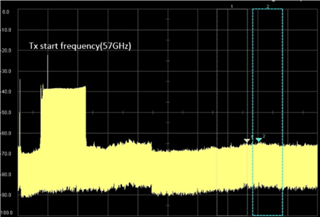

We are trying to measure the Tx start frequncy on our IWRL6432 custom board.
The Tx start frequency is being RF output from below the setting configuration value.
Please tell me why this happens that.
best regards,
Masaya.

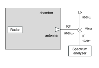

    1. What is the experiment set up?
    2. What configuration is being used?
    3. What does the plot signify?
    Swarnendu
  • Hi Swarnendu,
    we are  useing the folowing measurement system:
    Why this happens that?

  • Masaya,
    Thanks for sharing the details. If my understanding is correct, the IF is expected to be 1GHz and above (based on the 2GHz BW), but in the spectrum analyzer below 1GHz is detected. Could you please confirm this?
    I would like to ask the tolerance of the 56GHz LO. How accurate is the LO signal generator?
    Also, is it possible to directly measure the RF frequency? I understand if the spectrum analyzer does not have enough bandwidth.
    Technically Radar device cannot transmit below 57GHz. Therefore, I am more skeptical on the LO and the down converter accuracy.
    Swarnendu
  • Hi Swarnendu,
    Thank you for your response.
    Yes, your understanding is correct.
    We also check other chip IWR6843 is no problem, it is working RF output at the desired frequency.
    So, we think that LO tolerance is no plobrem.
    Please check if the 6432 is outputting at a frequency lower than 57GHz.
    Masaya
