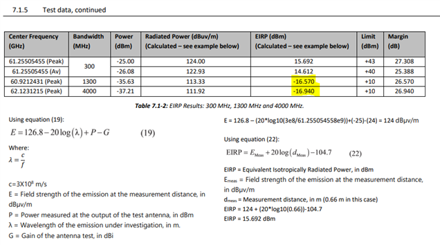

  • When looking 'fcc_47_cfr_part_15_255_subpart_c.pdf' document, there is below table. According to AWR6843(or IWR6843) datasheet, TX power is 12dBm. Considering antenna gain, EIRP should be around 15dBm or a bit higher. However, below table says higher bandwidth has much lower EIRP. How should we interpret this? Also, when I calculate EIRP with below calculation, it should be around 5dBm rater than -16dBm. Could you please clarify more here?

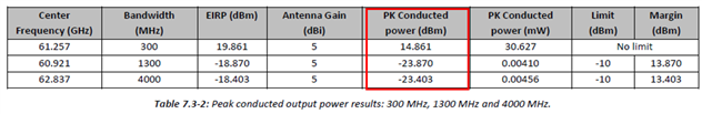

  • Also, when looking below table in same document, PK Conducted power is described as 14.861, -23.870, -23.403dBm. Similar with above question, how could it be so much different for different bandwidth? I should be around 12dBm(TX power of device), right? Do we have numbers that which TX power we used when getting certification?

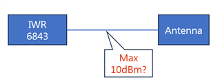

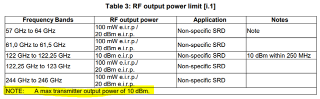

  • When looking 'EN 305 550 - V2.1.0 - Short Range Devices (SRD); Radio equipment to be used in the 40 GHz to 246 GHz frequency range; Harmonised Standard for access to radio spectrum' document, there is below table. What does the highlighted description mean? Does it mean that RADAR device has to limit its output power less than 10dBm? Meaning, EIRP(including antenna gain) limit is 20dBm but RADAR chip shouldn't exceed 10dBm TX power?

    • I tried to dig into the configurations that were used while testing this and unfortunately I couldn't find. But from my understanding this could be due to back-off configured and fundamental nature of FMCW signals sweeping rate. The input signal sweeping rate would be much faster than the settling time of the gaussian filter in the spectrum analyzer or EMI receiver. Hence the numbers are different for different bandwidths.
    • Yes the conducted power is limited to 10dBm and the E.I.R.P(conducted+antenna gain) is limited to 20dBm.

    However, still I and customer couldn't understand why the power has such severe difference based on just little different center frequency and bandwidth. I understand it can be different but it is too much different when looking the numbers where I highlighted.
    According to above data, seems our output power would be much degraded when using larger bandwidth. Could you please clarify my confusion here? When using larger bandwidth, is it general that TX output will be highly degraded?
    Victor Park
  • Hi Victor,
    As per the previous FCC regulations, the ISM band allows 40dBm output power and 10dBm for rest of the band. What I am thinking is we might be using a Tx Back-off in the higher bandwidth modes compared to the 500MHz BW(ISM).
    One more thing which I am suspecting is the FMCW correction factor. Usually, when these measurements are made using a spectrum analyzer or EMI receiver, the input signal sweeping rate would be much faster than the settling time of the gaussian filter in the spectrum analyzer or EMI receiver. To compensate for these measurement limitations, we use FMCW correction factor which is a function of Bandwidth and ramp end time of the chirp. These correction factors will be added to the final readings.
    I am suspecting that the test house might have skipped considering these correction factors.
    No, the output power won't degrade very much when using higher bandwidth chirps. It is the measurement limitation which makes the readings look like this.
    Kundan
