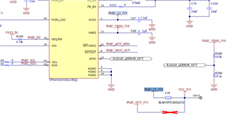

I'm working with the schematic of the AWRL6844EVM (PROC182) as reference design.
In the schematic I can'f find the source of the power supply net "RADAR_3V3". How is this voltage generated?

Hi Dusan,
RADAR_3V3 is generated from VCC_3V3 in the AWRL6844 EVM as shown below. VCC_3V3 is again generated from PMIC LDO output: PMIC_LS_3V3 as shown in the later image. Hope this helps.
- Page 8
- Page 5
