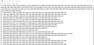

    3. Opened the Industrial Visualizer, made two modifications (which I will attach below), and generated a log file (which I will also attach).
    How can I analyze the log file to check the recorded data? Is there a way to convert or modify the file for better readability?
    You should be able to save logs in tera term. The logs from tera term would contain the data captured.
