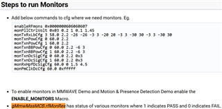

My board is IWRL6432AOPEVM, I am trying to run motion-presence detection demon on CCS, but however I want to print point cloud data on the console, should I set up the monitor?
Also I have 1. Monitor.cfg file contains all the commands from the above picture. 2. I changed ENABLE_MONITORS to 1. I dont know how to set this one: gMmwMssMCB.rfMonRes .
What should I do with the monitor if I want to run it to see the result, instead of visualizer?

    You don't need the monitor to print out the point cloud data on the console.  You can just use a System_printf() to print it out.  However, there is a latency with this operation so it may not print out the data immediately and what you see may not reflect what is seen by the sensor at that timestamp.  If you want to have the results in a format that you can parse offline, you can save the data while running it on the visualizer and look through the data that way.
